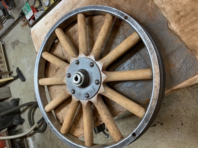

I prefer the natural look and just finished this wheel today. The picture is a before and after of the rear wheels from a 26 chassis that was turned into a farm wagon. We rescued the chassis from a barn and it was sunk in the mud for decades I’m guessing. The spokes were surprisingly sound but very dry. I took the wheel apart and sanded them to get down to the “fresh” wood and applied two coats of thinned Spar Urethane (to allow it to soak in) proceeded with about 8 coats full strength. Metal was painted with gloss Rustoleum (rattle can variety).
