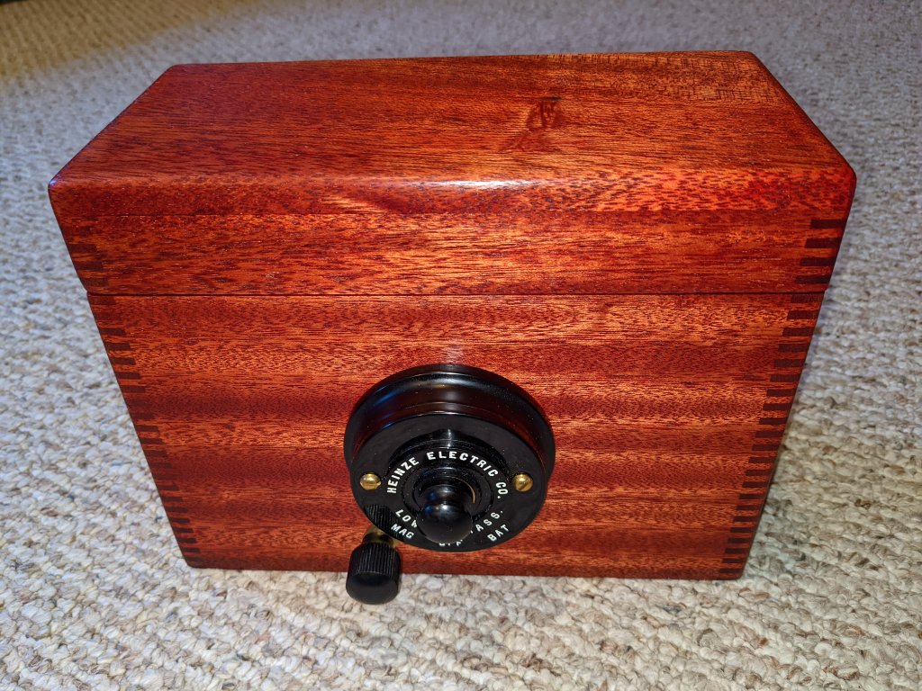

On New Years day I finished building for our 1911 touring restoration project this Heinze ignition box sized to accept the more "modern" KW coils. I got the box from Snyder's and the KW coils fit well without shimming. I stained it with Track of the Wolf cherry stain which I will also use on the replacement firewall.
I also rebuilt the brass KW coils that I got from Erik Larson. Thanks Erik!
Neal

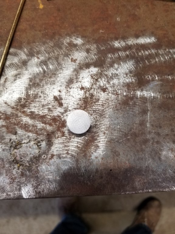

Getting ready to install the Twin Hasslers on the TT. Built up the Hassler bolts.
Had to fix the worn holes in the one side
I bored the hole larger and cut a disk and brazed it in place
I bored the hole the correct size and painted it and its ready to install.

Photo of disk just a bit thinner than original.
After brazing and boring.
you can see color difference in disc and braze. I think it should last many more miles.

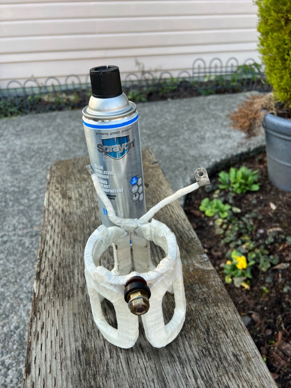

Repaired and rewrapped a field coil for a starter I’m refurbishing. Special thanks to Ron Patterson for his numerous previous posts on the subject, to contributors to the MTFCA books, and to Hank Lee for offering the starter on the classifieds.
I used the High-Strength Fiberglass Electrical Tape with silicone adhesive from McMasters Carr as recommended on previous posts on MTFCA forum.
Product #'s 7574A35 and 7574A11
I used the 1/4” tape to replace some of the paper that was in between the coils, and one and a half rolls of the 1/2” tape for two layers around the coils. Then two coats of the spray insulating varnish.
