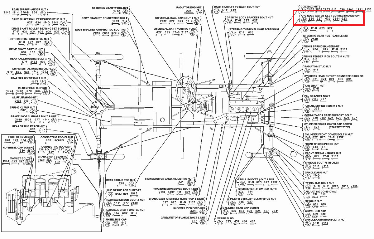

I’m in the process of removing the water pump and putting the original style water inlet back on my 26. I assume I will be buying a bergs after I get things running, but I’d like to take this link out of the cooling system. The bolts that came off the water pump are modern grade 5 bolts and barely cleared the replacement inlet and horn bracket from Lang’s. What is the correct length and material? Is zinc plated ok? I found some replacements, but I’m afraid they may be too long (I’ll measure when I get home). I’m not concerned about the looks, I’ll just paint them black anyways. They are 7/16’s coarse thread correct?

It will have a dome head to the bolts like the head bolts have. No zinc plate, either painted steel or nickel plated. Water outlet bolts are domed too.

Bruce's "Comprehensive Model T Encyclopedia" [available: http://mtfca.com/encyclo/mccalley.htm or from the vendors] often will have the item listed along with better dimensions and TPI. For example part # 3016 that holds the side water inlet onto the block is listed "SCREW (Water inlet connection, 7/16 x 1-1/2� x 14 T.P.I.)" (Why it uses the term Screw when it looks like a bolt � I�m not sure � but that is what the catalog used. Note many of the vendors also use the same part numbers as the original Price List of Parts � that can be helpful in tracking thing down.)
The chart references the bolt head size and tools that can be used on it in that location

Thanks to everyone for the help, and the fastener chart and links. I bought some 2 inch long bolts the other day, and they seemed too long, the 1 inch bolts holding the water pump on were definitely too short, so I’m glad I can confidently go find the 1.5 inch ones. Does the finish/material/grade matter? It looks like zinc plated grade 5 is the most common.

The finish/material/grade bolt does not matter for a water inlet. Modern zinc or cad bolts are not the right finish, and a modern hex head is the wrong shape, they will work, but look wrong. Model T bolts that I have had tested were somewhere less than a modern grade 2 bolt. You can use a grade 2, or greater, your choice. If you got a grade 9 bolt, it has a higher head, you can grind or turn it to make a dome head. Or you could get a dome head bolt from the vendors.
Any modern bolt with any finish, in any grade will work, not look right, but work. You asked. And if you keep your hood closed, who would know.

A not so common know fact is if you measure the head of a bolt, the threaded area will be 3/16th inch smaller.
For those bolts and the head bolts, a 5/8th inch wrench is required, so the bolt is 10/16th minus 3/16th or 7/16th inch.
Then you have to determine if it is national course or national fine threaded.
Of course, there are exceptions to all the rules and the Model T has a few of them.
The bolts holding the generator in place, on the later 1919 to 1927 Ts that have one, are an exception with a size larger head.
There are three places that use Size 14 X 24 screws or nuts that have been obsolete for many years.

And of course we have the BOLT CHARTS on the Gallery Section, that are just waiting for corrections and missing details to be added. Feel free to have a look at PM me the corrections/ missing data :-) https://mtfca.com/phpBB3/app.php/gallery/album/195
(Thanks to those who did this some time ago and my apologies that I lost the replies... which is why they have not been updated... (hangs head in shame) )
You may be interested to know that HEAD BOLTS were, in fact referred to as CYLINDER HEAD CAP SCREWS 'back in the day': https://mtfca.com/phpBB3/app.php/gallery/image/1507
