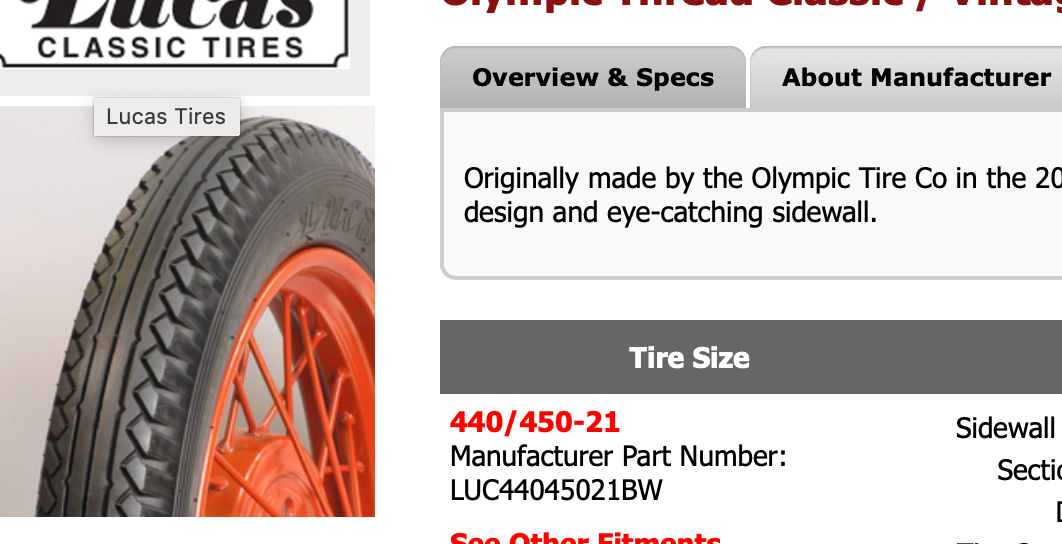

As for the motorcycle rims in that Jan Feb issue of Vintage Ford, those were custom blanks, and in 21" rim size for the std. 21" balloon tires.
The tires in the article have "LUCAS" on the sidewall, so believe these to be std. 440/450x21 tires. Those alum rim disc blanks can be found in sizes from 16" to 21" , the 21" being 2.15" wide rim, so fits up to T size balloon tire! And pretty cool adaption for use on that T truck by the owner.
Answer would be no for motorcycle tire to use on T clincher rims, for the tire patch coverage as mentioned.ead the MTFCA article about a T'er who installed 21" motorcycle wheels with T tires on his '24 T C-Cab. Conversely, would comparably sized motorcycle tires fit onto 30x3 or 30x3-1/2 rims?
