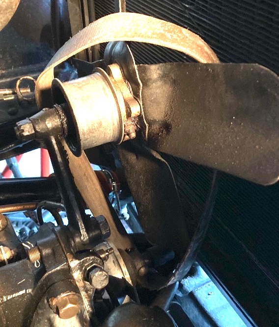

Yes, at least the crank pulley is aftermarket. Not sure about the fan. I’ll post pics if I can with this reply. Gerrit

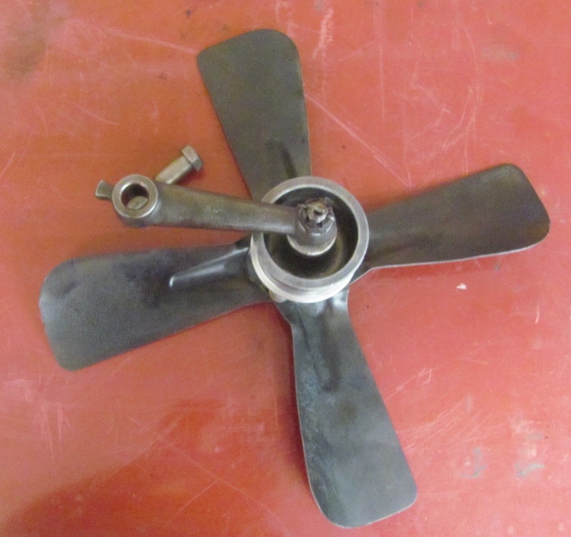

Here is your photo lightened up some, the fan is ok later '24 type blade, but at times the fan bracket can get bent. From the angle of your photo it would appear the bracket is out of shape. You could try to shim the bracket out with thin spacers or washers behind the bracket at the large retaining bolt or bend it straight (on the bench vise, take it apart) to get alignment, cold bend is ok, tough Ford steel part.
Here is aligned stock '23 fan.
'23 fan
Note the bracket is rather straight in stock shape, the zerf fitting is incorrect, should be a cover screw as heavy oil not grease should be used in this type fan pulley.

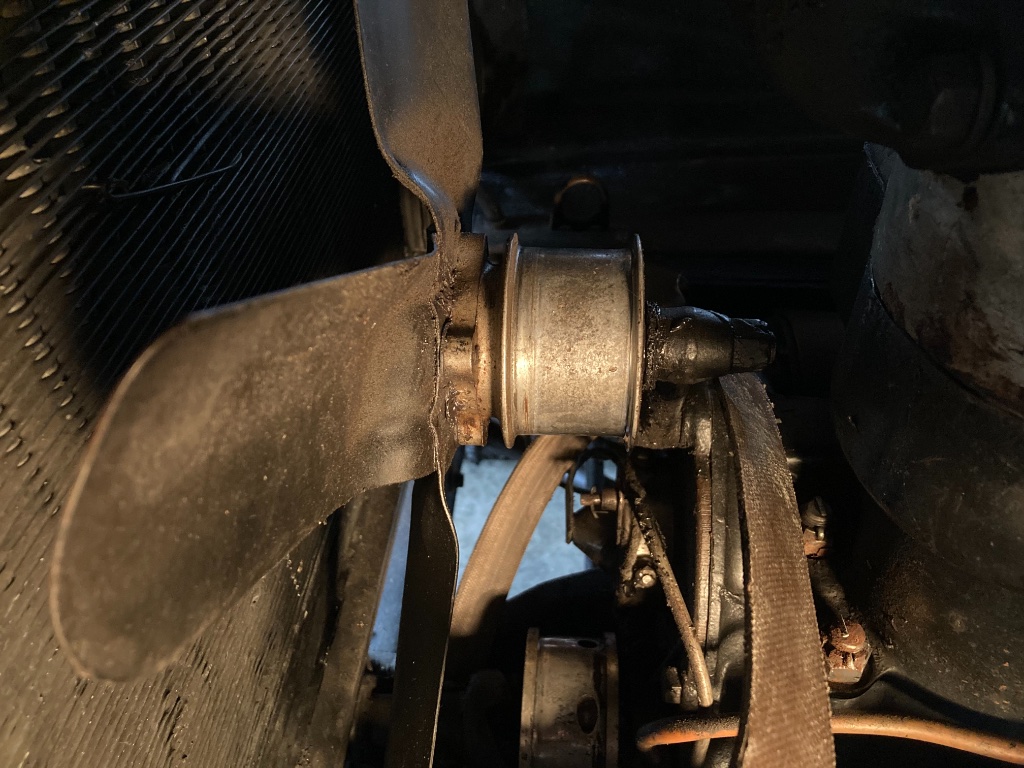

Thank you Dan but what I am seeing is the fan pulley about a half-inch forward of the crank pulley. Unless I am misunderstanding something about your explanation I’m not sure how shimming it up will get me back in alignment with the bottom pulley. It may be the case that I have to return the crank pulley to original as I’m told this is aftermarket. I’ll talk with my club members and see how to proceed. I wanted to post this here to see if there was a quick and easy solution but I think it’s going to be more involved. A good opportunity to learn about my car—putting a positive spin on it :roll: ...Thanks again. Gerrit

Re-pop crank pulley. Compare pin location to stock.
Your fan pulley is SHOT, worn out. There should be a crown to keep the belt tracking properly. Yours actually has a negative crown. It will give you trouble. Good candidate for a ball bearing pulley.

In addition to the previous comments and based on the pictures, it looks like there are thick washers at the fan shaft pulley and bracket and at the other end of the bracket. Just surmising.

Going by the photo concerning the pulleys being lined up it doesn’t look like it’s more than maybe 3/8” or less out of alignment but they may be because of the angle of the photo.
I would install an original style crank pulley first and go from there. It’s probably been out supposedly a little for years and probably didn’t give any issues. My 21 Touring isn’t in exact alignment and hadn’t given any issues. It does have the original style crank pulley which somewhat allows an offset alignment because it doesn’t have the flanges on the pulley.
The belt can align itself by being able to move over just a little.

Your crank pulley was almost certainly replaced with this one, due to the belt constantly flying off. As mentioned earlier, the fan pulley is horribly worn and having pulleys even perfectly lined up with a new stock crank pulley, will still result in the belt coming off.
For starters, both pulleys must be crowned and then work alignment. With a correct pulley of the correct diameter on the crank and then a replacement original fan pulley, I'll bet that alignment will be quite close and can be managed from there. In fact, bone stock parts and correct repair/replacement methods will all but certainly remove misalignment without even trying.
Even with misalignment of some degree, a belt will always track to the "high" point on a crowned pulley even when faulty common sense says that it will want to run off (it won't).
