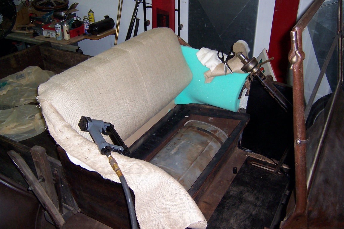

Stuffing the old spring coils vertically with squares of foam works to give the whole spring a re-fresh, that is what made the seat back firmer on the '23 barn cut-down. Wasn't going for original anyway, just comfort!

For proper repair of coil spring seat base, you can reshape the coils by stretching them back level to each other, then re-tie and reinforce the placing with music wire, that is hardened, and you have to use tough pulls and good tools to wrap and twist the wires in place. Works for times you cannot get a replacement seat spring. Did that for this aftermarket body, wanted to preserve the original springs that were OK, just sagging in spots.
