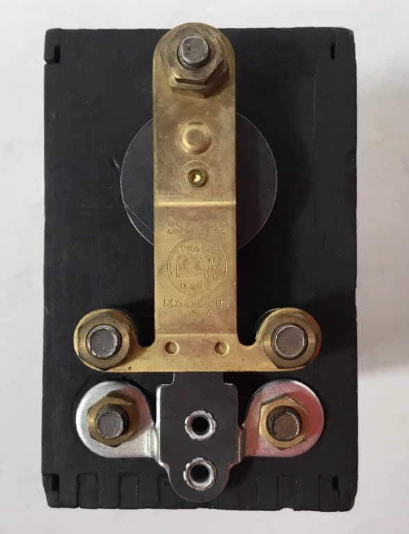

Post by jiminbartow » Sat Feb 19, 2022 5:55 pm
Good evening. What years does this size spark coil fit? I know it fits the 1926 and ‘27, but I’m not sure of the other years it fits. If I’m not mistaken, the earlier years used a different size. Thank you for your help. Jim Patrick

I don't know the exact year for that particular coil, but it is a standard Ford coil and It will fit a 20, 22, 25 and 26. So I suspect that all the years between those will fit also. Don't know whether it will fit the Brass era T's.

Nice clear, vibrant close-up pictures. It’ll ‘fit’ in a 14-16 coil box but wouldn’t be correct. Otherwise, it’ll fit and be correct for all 17-27 Model T s.

Thank you. Yes. It is standard. It came out of my ‘26 coupe… So, it will fit the 1920,‘21,‘22,‘23,’24,’25,’26 and 1927, but not the 1919 and earlier? Thank you. Jim Patrick

It will fit as far back as early year of 1913

I just checked Lang’s online catalog and it said this coil would fit 1914-1927. If I put that in my description, would it be wrong or misleading? Would this coil work in a 1914, 1915 and 1916? Thank you all very much. I just need to get this right, for sure. Jim Patrick

Brass top coils are correct for '14 - '16 - in that neighborhood, although that one does fit.

Yes Jim. As I stated at 5:29 pm today, it’ll fit and work in a 14-16 coil box too. Correct for 17-27.

Early brass Ts used a variety of manufacturers, and they changed models and dimensions a few times. For 1913, Ford decided to standardize the coil design and fit. The actual change was made about mid model year for 1913, or about May of 1913. Many earlier model Ts had their coil boxes changed to the new style for reliability and maintenance reasons.
Properly stated, it "fits and works originally from mid 1913 through 1927 model T Fords." It "fits and is authentically correct for 1918 through 1927 model T Fords."
The technicality is that mid 1913 through 1916 model T Fords used brass/copper topped coils (some of which were coated in a black oxide originally!). And many 1917s used an odd black experimental plastic case that didn't work out very well. Most of those experimental plastic coils warped and began failing quickly. Ford discontinued them before 1917 was over, and went to the all wooden coil like you have. People wanting to "properly" restore their 1913 through 1917 model T may choose to insist upon either the brass/copper top or the odd plastic coils as a special detail. People wanting a driver T usually don't care and cover the coils with the box's lid anyway. So the top of the coils can't be seen anyway. And the later wood-topped coils fit and work perfectly in the mid 1913 and later brass era coil boxes.

The specific coil depicted in your photos is typical of the "standard" size (non metal top) coil adopted for the Model T mid year 1917 and can be used in the metal coilbox that was introduced in mid year 1913 and used till thge end of Model T production.
The "standard" size all wood and metal top coil are interchangeable in any metal coilbox with the exception that metal top coils (1913 to mid year 1917) should not be used in the 1926-27 metal coilbox. The the coilbox lid spring tabs that securely hold the coils in place inside the coilbox will interfere with the raised metal stamping. The tabs will distort and can short the coil points to ground.
A few comments about the specific coil pictured above. After the Wheat gluten cast design was withdrawn and the standard all wood was adopted there was a short time when coils made by Ford had no Ford script. The branded Ford script showing first appeared in 1919 (I have forgotten the exact date) and was changed to the rolled in script on the top edge of the wood case top in February 1923 and remained unchaged till the end of Model T production.

I have seen examples of later coils with the Ford script at the top, and in the center.

Everyone, the best document I came across regarding Ford coils is The Model T Ignition Coil by Trent Boggess and Ronald Patterson. I understand it was originally in the Vintage Ford. Then I think it was available at a vendors website. But I could only find it here: https://studylib.net/doc/8191195/the-mo ... ition-coil.
In this Forty pages of information you will see the coil in question is listed as a 1919-1923.
