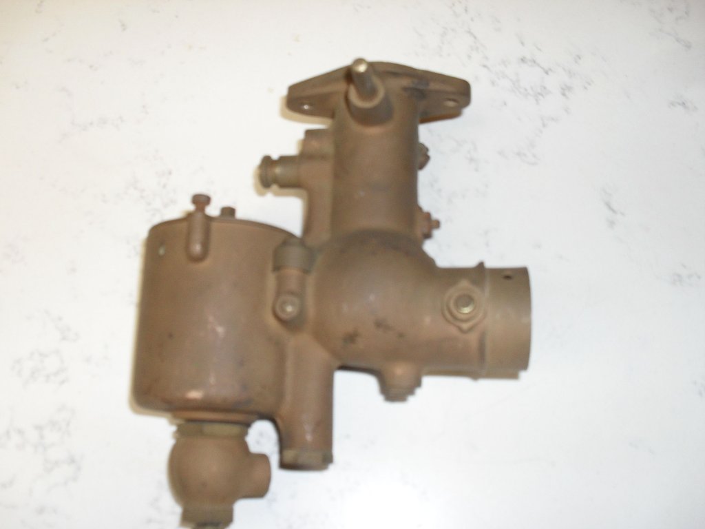

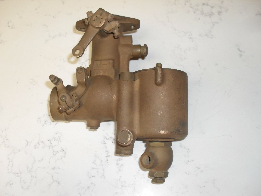

Pictured here is my Stromberg M1 carb. There is a needle screw that is missing, shown in the picture. Does anyone have a spare or know where to go to get this part? I think there is a cover or screw missing on the float chamber also. Tom The needle valve that I need is pictured in this edited post

Thanks, Scott for your reply. I sent a picture of the needle valve that I need. It is shorter than the one you posted. Tom

After looking my carb over a little closer, I find that the needle valve that I need is the longer one, like the one's shown in some of these posts. I measured it to be 2 and 7/8" long.

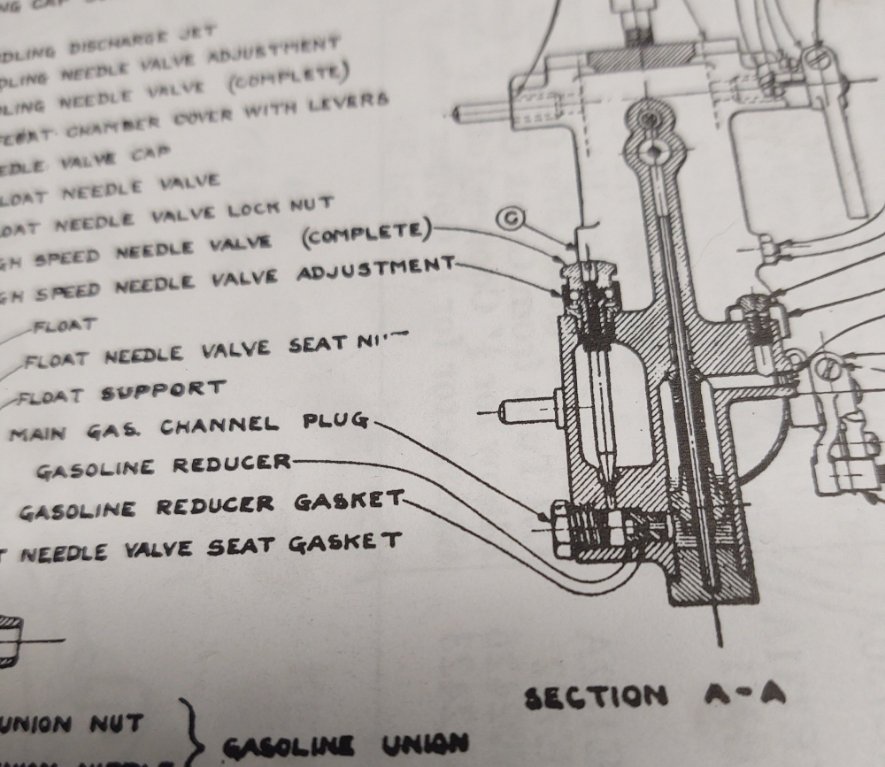

EDIT: 3-02-22: Correct.jpg. A view from the M series books. A cutaway view.
