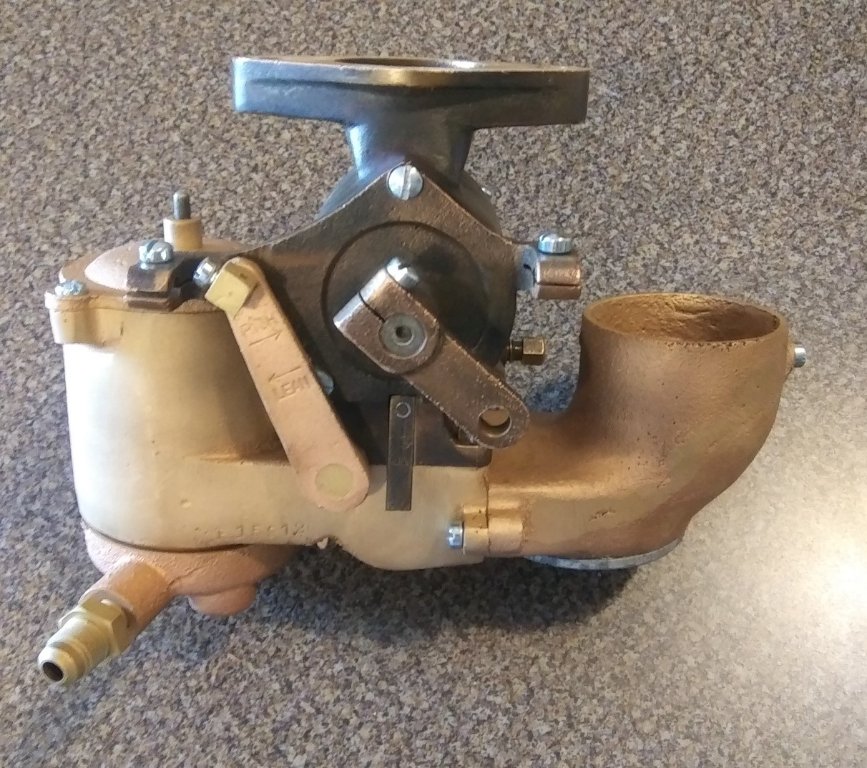

I have one of the zeniths that was built for use on the T with the throttle body turned 90 degrees from standard, along with a cast iron zenith manifold. It’s a nice setup, but won’t work on the B. I have a couple of normal 04s that would look good as a pair (if the would fit).

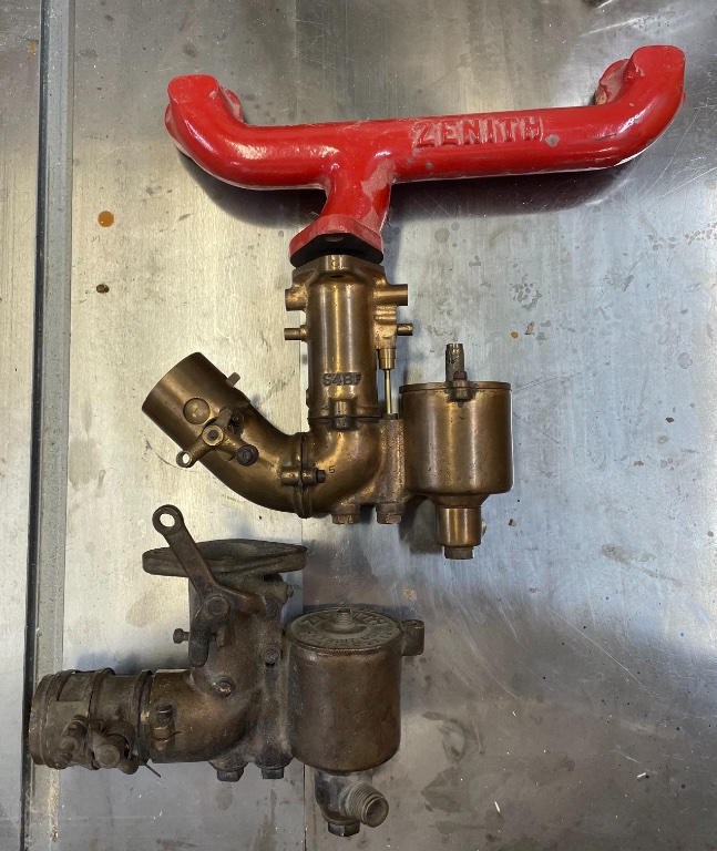

We have had excellent performance from the Zenith L-6 bronze carb that is on #2. The carb and manifold was on one of the Rajo racing engines on display at the Harrah's auto museum back in the 1960s. Somehow I ended up with that engine and as we were constructing #2 it had a B head on it and so I robbed the manifold and Zenith carb off of that engine and it has performed flawlessly with probably 7 to 10,000 miles on it. And speeds up to 100 MPH (tall gear ratio) The only hitch is starting on a warm engine, sometimes you have to crank multiple times (no starter) to get it started. Could be the design of the manifold. Zenith manual states " no Y type manifold you need a log type", and this has an aluminum Y type.

Thanks. I have a couple Zeniths on hand. Good advice about the log style intake.

Your typical model M or possibly an L ? Zenith bronze updraft carb as pictured on the #2 Car above. I don't know much about the model letters or sizes offered but typically are IE: 1 2 3 4 and larger.Reno Speedster wrote: ↑Sat Mar 05, 2022 2:41 pmDavid, any recommendations on which zenith would be the best choice?
They were made with various different flange and throttle orientations so with some searching you can find one that will work for your setup.

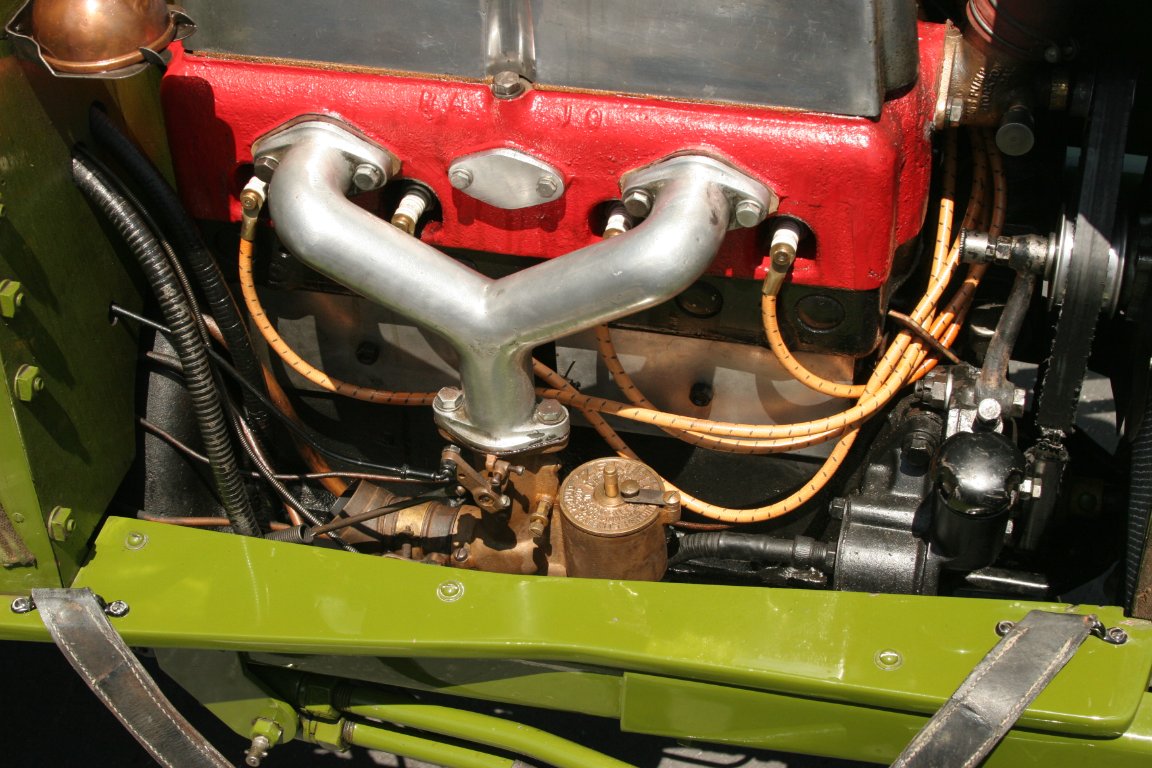

I am interested that Ed Archer indicates he runs a Zenith L-6 on his #2 car. I have checked out a couple of L-6's, and the main throat diameter measures 1.660". I have thought that likely is too much for most Model T motors, though I also recall reading somewhere that the Indianapolis car in 1923(?) ran a pair of L-6 carbs. I have also checked out several L-5 Zeniths, which have throat diameter of 1.440", and O-4's which have throat diameter of 1.180".
Certainly it depends on an bunch of other factors as to how the particular engine breathes, but wouldn't a smaller carb be easier to manage for street use? I am intrigued with how a pair of O-4's would work on a custom manifold. I am sure they would LOOK great!

While we are talking about Zenith's this is a very rare aluminum Zenith L6 carb on the engine in the photo. I purchased it from friend Josh Houlton in 2009 for use on a T racing engine I was planning to build with a Rajo BB head I took off a client's Mercury Speedster engine and later bought the head from him in 1986.
After quite a bit of research it was found to be a racing car carb, as it is different than bronze L's, and never had any provision for a choke or hot air tube and has its original large bolt-on velocity stack, and a 1.625" throat. There was a similar aviation version that had a choke flap and a provision for a hot air tube.
It was taken apart and inspected and cleaned and found not to need any other work. I'm now planning on using it on a racing engine in an un-restored 1913 "T" racing car. That engine has Fronty S-R head and a Fronty DOHC crankshaft.

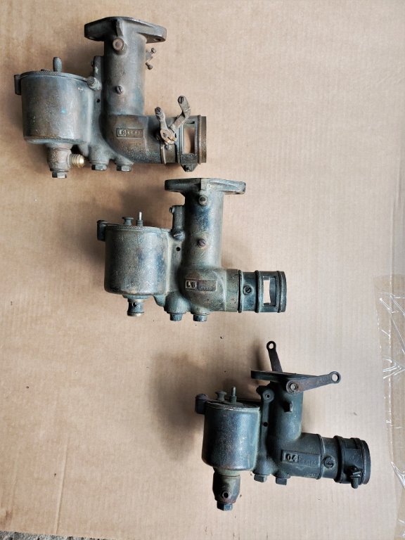

Here are the two I have. The one in the top with the manifold is an S4BF, which is for a T. It has a bore of 1.175. You might notice some parts are not in it. I have them all in a bag.
The one on the bottom is a 04 with a bore of 1.165. This seems a bit small. But if I could find another….

Tim I think Ed was refering to the #2 car running a L-6. If I remember correctly that car used to run twin side draft linkert Or shebler carbs with a
1 1/4" or so bore. All I know is it realy runs well.
