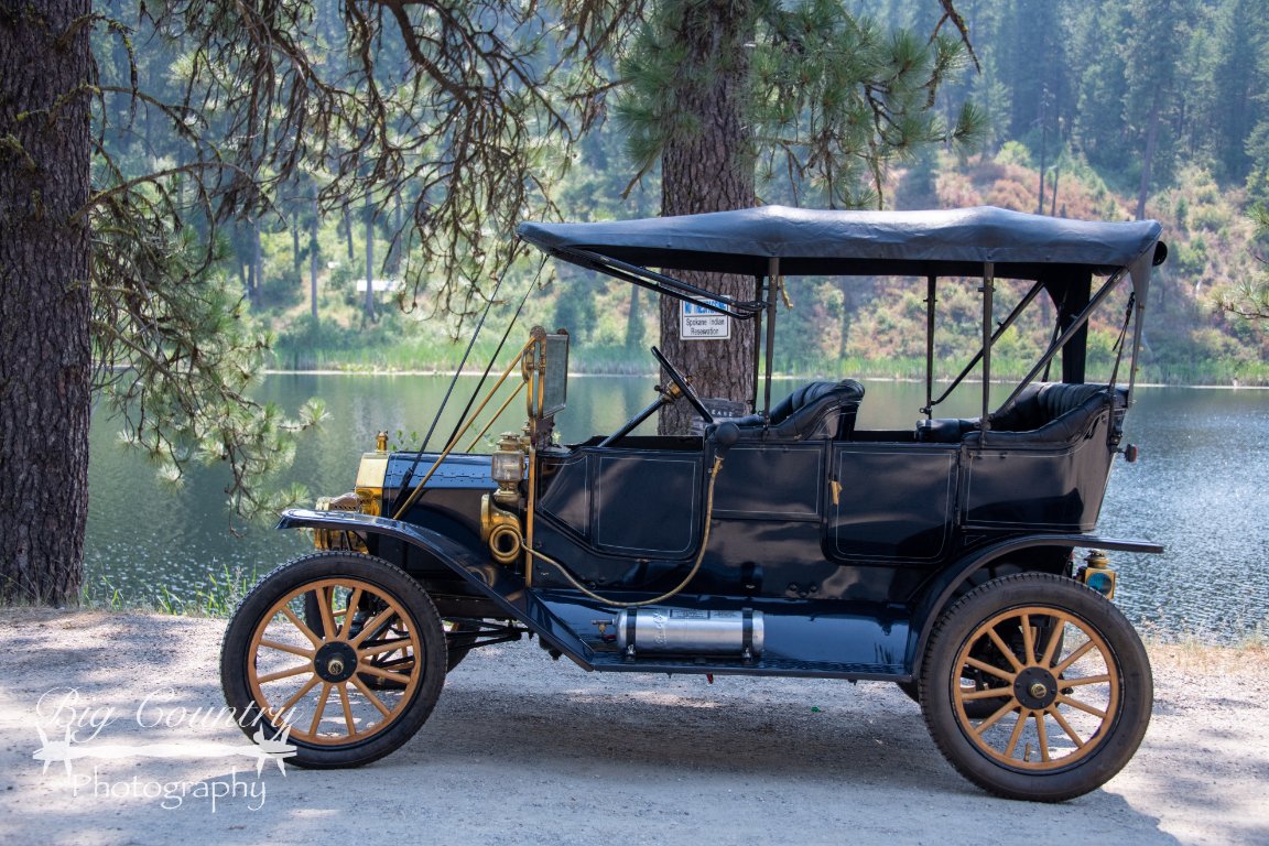

Re: Best blue for 1912
Post by John Heaman » Tue Mar 08, 2022 1:20 pm
A friend of mine owns this 1912, and it is such a dark blue it does indeed look black. The fenders and running boards are black, so as you can see there is not a lot of contrast!
