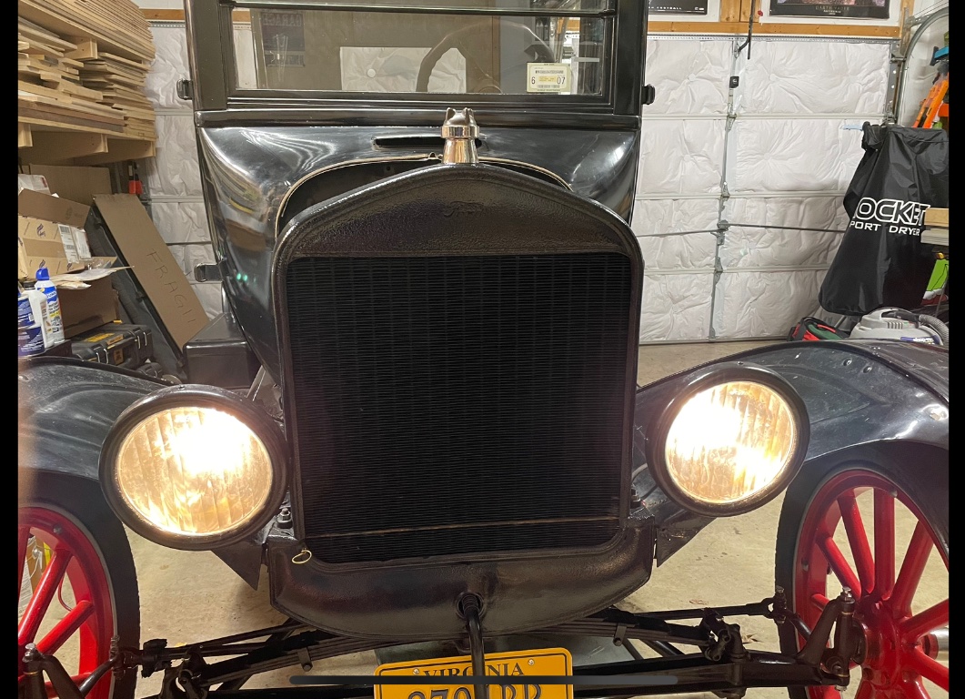

Woot woot! Thank you everyone! Got the headlights going. Now on to the tail light. I painted that as well. Where is the ground on that one?
Also, my headlights work but when I switch to dim, nothing.
