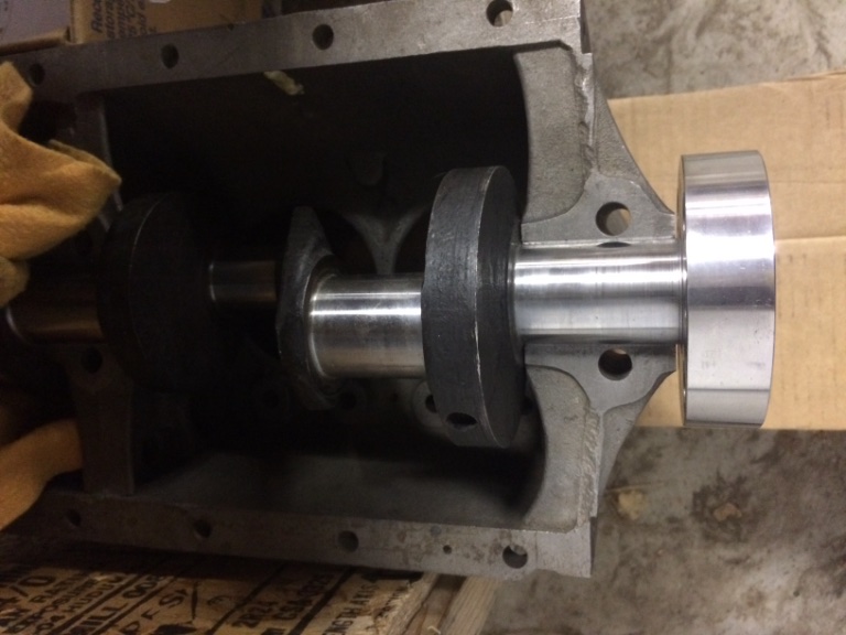

Re: Model ‘A’ and ‘B’ crank shortening for ‘T’ & Related Questions
Press/shrink fit shortened A crank
Another approach that works!!!!!!
Skinning thou cat!!!!!!
