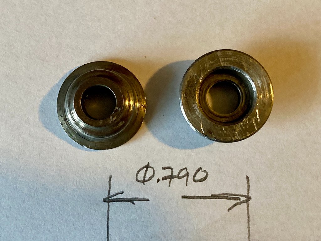

Found these tearing down an engine with an older rebuild. The valves have .030 oversize stems (.342), Model A springs, these retainers and the stock Model T valve pin? I thought they may be a "modern retainer for use with the split keepers or Ford Tractor (8N,9N), but I can't find any good enough pictures on the web to help identify. Thanks
						What Spring Retainer is this?

Looks like it's for Free Rotor valves, these used to be fairly common on industrial engines, takes two c- shaped keepers, and an inverted cup over the end of the valve only example I can think of is Fordson Major, but there's way more.. Dave in Bellingham, Wa
