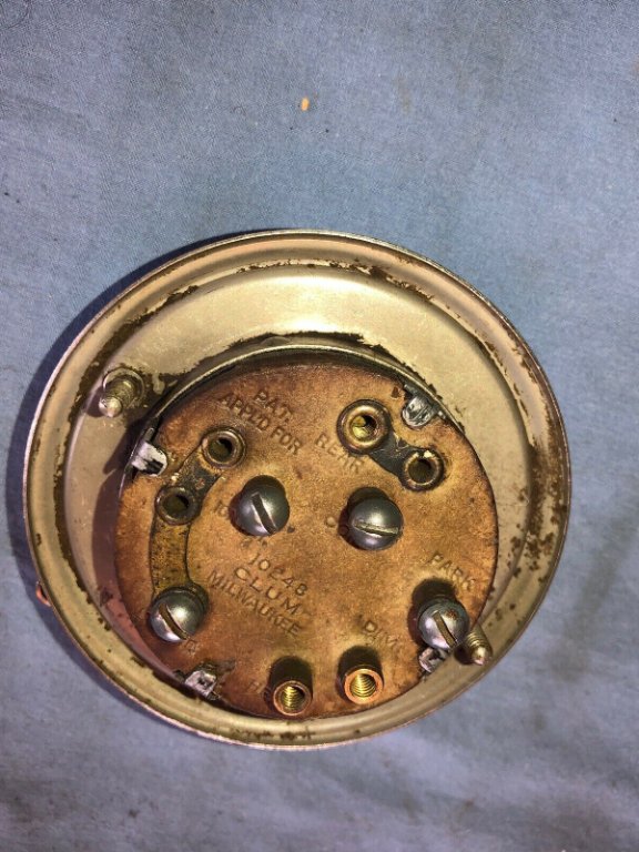

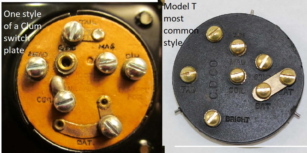

The description of repairing the switch is no different than it would be for the pin type that the Model T suppliers sell (when in stock). However the layout is not exactly the same. But there are Clum backing plates that are the same as the common Model T so its necessary to see the backing plate and internal parts to properly ID a switch.
Ignition switch wiring screws.jpg (94.45 KiB) Viewed 1881 times
The following shows a switch backing plate that is even different than the two above
and another Clum for a different switch
Posts: 6542
Re: starter switch information
Post by TRDxB2 » Fri Mar 25, 2022 3:06 am
and there are more variations not just from the outside but inside as well

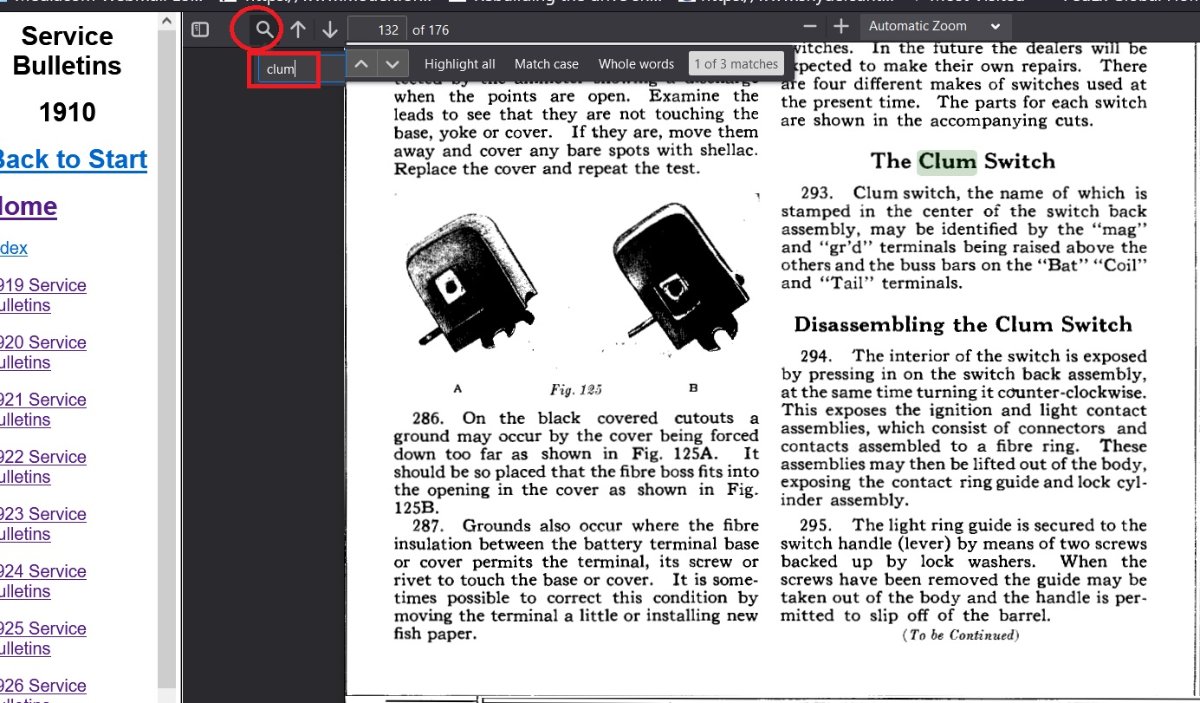

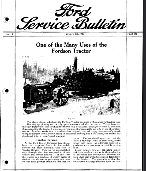

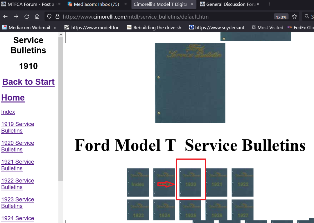

I may have found the source of what you have a copy of. Same everything but page numbers are different
This is a great reference www.cimorelli.com/mtdl/default.htm
-- I then selected Bulletins
Didn't know which so I started to search 1919 - nothing
--Then1920 and git a hit (To search click on the magnifying glall then enter the search word and hit the ENTER key (@takes a bit to find it)
-- the documents are PDF's you can skip the above and just go to the 1920 Service Bulletin www.cimorelli.com/mtdl/service_bulletins/sb1920.pdf

Bottom line: the Cimorelli site Frank posted has all of them.
