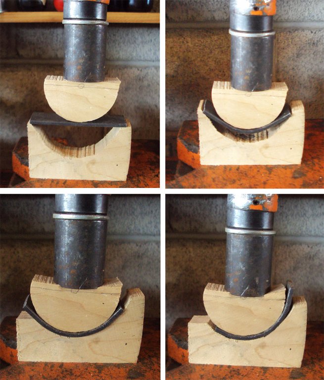

I think pressing a piece of steel into some hardwood or steel forms would work well. Maybe even a big C-clamp.
What make is it? I might give it a try if you don't get any offers.

That’s a Victor #2 lamp, isn’t it ? There’s plenty of lamp restorers out there that probably have available parts. Contact Bill Glass. 🇺🇦

Yep, It can be done. I'll keep going in case you don't find a real one. It fits my Victor. Others may be the same.
Re: Kerosene Lamp Hardware
Post by Rich Eagle » Sun Mar 27, 2022 7:50 pm
Anyhow, that's how I would make one if I had some spare time on a Sunday afternoon.

Pretty slick Rich. You make it look easy.
Post by Rich Eagle » Mon Mar 28, 2022 3:11 pm
Thanks Dallas. It was an easy part to make. Having the right thickness on hand helped. The square hole is a touch bigger but I can make a bolt that fits it. I'll add it to my Victor collection should I ever need it. It's another sample of what we can make.

Rich E, I love seeing your posts about how you make parts!
For the life of me, I cannot remember what car it was for? Might have been the 1914 pickup I had years ago, and had to sell before I finished it (I sometimes try to forget about that one). But I had made one of those pieces in much the way you did.
I really like the way you pressed that steel piece. I was brutal when I did mine. Found a scrap of strap iron the right thickness, slit it down the side to the proper width. Then hammered it rounded over a scrap of pipe to match the one from a matching lamp. I carefully copied and marked the holes and slots, then drilled a series of small holes, leaving a bit of room to file to fit. It didn't take as long to clean it up with good small files as I thought it would. Maybe about twenty minutes? The entire process took maybe a bit over an hour. I could have spent that much time searching small boxes at a swap meet (if there was a swap meet to go to?), and not found one.
Post by Rich Eagle » Mon Mar 28, 2022 5:45 pm
It is fun Wayne. I hadn't made much lately and a few glitches popped up. First I cut the width 1" and had to re-saw it to 7/8". Then I used the original to locate the notch and marked it backwards. I'm glad I checked it before sawing. There are dozens of ways to go wrong especially when I'm out of practice.
