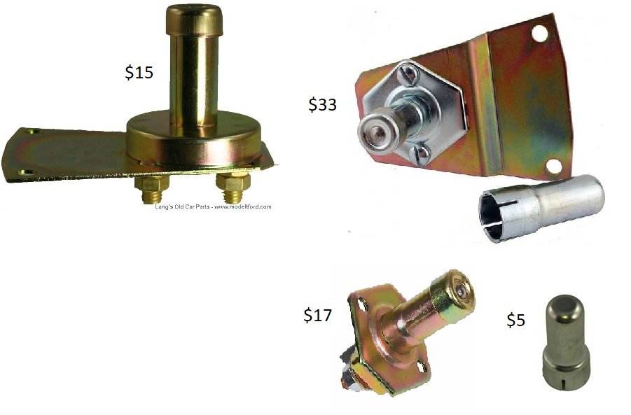

Post by BLB27 » Tue Mar 29, 2022 7:01 pm
The suppliers have two different switches. One is priced at about $33 and the other at about $17. They are of both. The cheaper one may be available before the other one.
Has anyone had experience with these two?

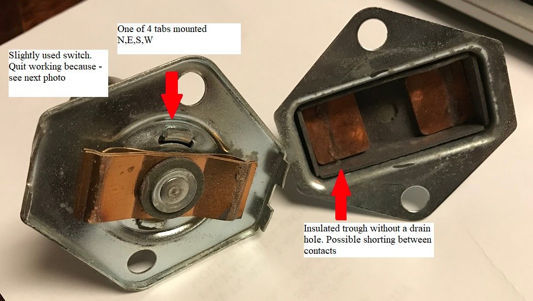

Yes I have. I've prepared an unfavorable response. Haveing said that this was about 18months ago and designs change, inventory doesn't always change with it. Personally I prefer a starter button and starter solenoid - its safer than stepping on a fire starter. My second choice would be an original starter switch. They are beefy solid constructed switches. The ones with tabs don't favor any maintenance (tabs brake off), ones that allow maintenance by removing screws are preferred and reliable.
This is effectively what you would buy.
I have no experience with the one with the round base.
Here is the problem that I experienced. The switch being mounted on the for is foot actuated. If is is depressed vertically downward 100% of the time, likely no problem. The switch MUST be pushed downward and evenly so its contacts can bridge the posts inside the switch. However, that is not always the case and when a forward or side to side force is applied the plunger tabs will bend and eventually only one contact will be made unless you readjust your foot position. The second issue is that the compartment that encloses the contacts has no drain.

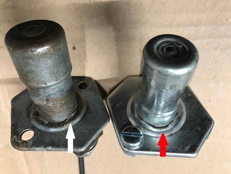

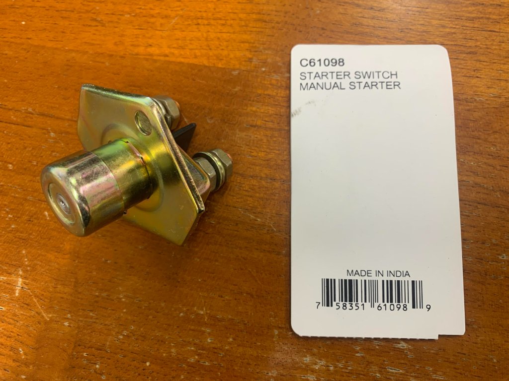

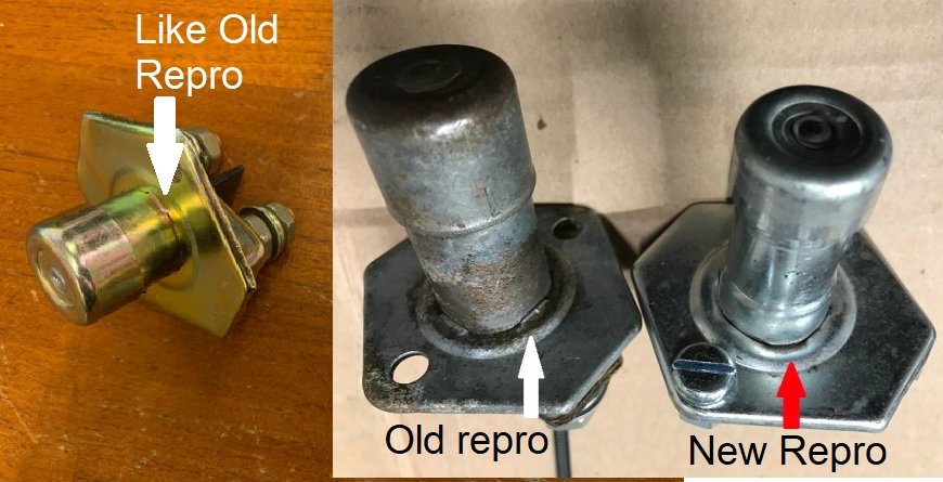

It wouldn't be difficult to have one that is "Better" Quality than another one.
I had purchased a "better quality" about 2 years ago and the design issues I had with it may have been corrected. But so here is an attempt to explain one of the issues with the earlier switches. This does not mean that the current ones don't have the same issue.
The design issue is the tube containing the plunger is help in place on the bottom by 4 bent tabs. One the plunger us depressed straight down gently about 1/4" there is no issue. HOWEVER, that motion isn't always possible due to ones anatomy, since the plunger is spring loaded some regulated force is needed to depress is just enough, also frustration to get the car started might cause someone to pus harder. So a light forward force is exerted eventually bend the tabs and/or bottom plate causing only the forward pad to contact on the starter side. If one rocks their foot back a bit to cause both of the internal pads to make contact with the bolts to complete the circuit the starter will engage. Bending metal back and forth and something will brake off (small tabs inside, short?). Now this issue could be corrected if the tube was secured more firmly to the base plate. Note the difference between the old and new repro's
The other issues with the one shown here is that units are not sealed form water etc. Inside the bottom of the switch is a rubber insulating tub with no drain holes. If water was to get inside it - 100% short. The round design doesn't appear to have this issue.
So if you do purchase one of these I suggest you take it upon yourself to remedy the issues .

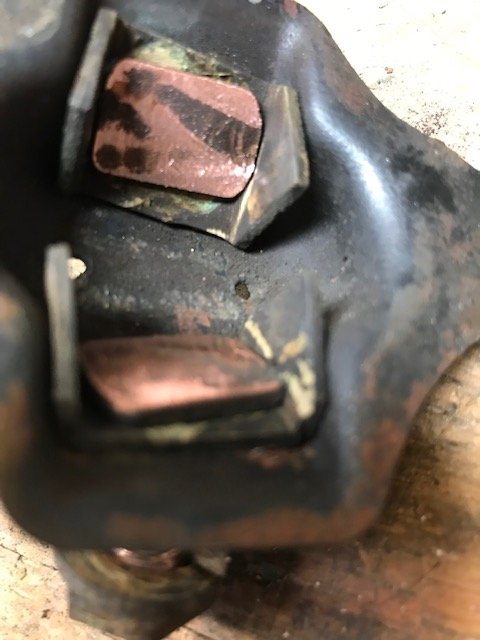

I am working on getting my 1919 Tudor running after over 70 years of barn storage. This forum has been a tremendous help. After reading all the posts on this subject (thank you all contributors) I am going to use my original foot operated starter button to activate a new solenoid relay. The starter button did not work so I took it apart and cleaned the contacts but the pitting reduced the surface area by 50% and I didn't dare file them down anymore. Also, the upper contacts are narrow so even less contact. I shall also put a 30 amp fuse in-between the battery + terminal and the foot operated starter button. The previous post also suggested that a "cheap toggle switch under the seat or something" could also go between the battery and the old foot operated starter button to prevent unintended starts if someone accidentally steps on the starter button. I like the idea. I am wondering if one can accomplish the same result by not connecting the foot operated starter button to the battery but instead to the coil terminal on the coil box. The coil box is connected to the battery by operation of the existing switch on the dash. So, by moving the dash switch to BAT the foot operated starter button also becomes connected to the battery. When the dash switch is in the OFF position, pressing the foot operated starter button would have no effect. The thing I don't know is what happens if the dash switch is to MAG. It seems to me that the magneto would then be connected to the foot operated starter button but nothing would happen unless someone accidentally stepped on it in which case current from the magneto would be sent through the 30 amp fuse to the starter solenoid ... and then what? My question: Is my idea to power the foot operated starter button and consequently the solenoid relay by connecting it to the MAG terminal (on the coil box terminal on the outside of the "firewall" a good idea or a bad one?

First: Welcome to the hobby
Second: Go slow
Third: doing an internet search starting with "MTFCA your subject" will bring up multiple posts for any possible subject including wiring diagrams which I will mention below...
The MAG only produces power when the engine is rotating, thus providing (in your case) power to the plugs to keep the engine running...nothing else. Thus, to your question at the end of your post, it is neither good or bad...it is simply wrong insofar as how things work.
To be the most helpful without being too blunt, you can try to follow 20 guys replying to you with opinions and ideas, some of which will be good and some which will likely be dubious, or you can get a copy of the wiring in your car and trace things out...you will soon see why your question cannot really be answered as "good" or "bad".
With regards to your other post, the key switches from BAT to OFF to MAG to connect the ignition system to either the battery or the internal magneto...the tab on your assembly chooses the headlight intensity (or at least used to when original bulbs were being produced).
NOTE: your switch is unique and a bit rare, being supplied on the very first starter-equipped cars in 1919...do not be talked out of it or swap it for a rebuilt unit. Your generator and starter may well still be the unique ones fitted to the car, too. Research them before discarding or swapping them out.

Post by John E. Guitar » Mon Oct 17, 2022 10:59 pm
I bought this switch at a Tractor Supply shop last time I was in Kansas. I'm planning to fit it to my car on the weekend. It's made in India. The quality looks ok.
The part number is C61098.

Post by TRDxB2 » Tue Oct 18, 2022 12:44 am
You may have found a good replacement. The tabs holding the plunger tube are like the old repro's which were decent. Also the shortness of the plunger tube is a benefit. All depends on the quality & thickness of the metal. 🙏
