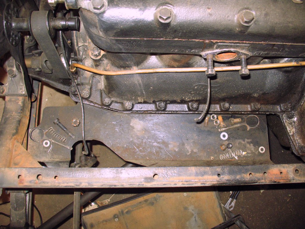

First one is dustshields between the crankcase and the frame and the "where do they go" question's answer is: "in the trash the first time someone worked on the engine"

The first ones fill the space between the oil pan and frame, enclosing the bottom of the engine compartment. It attaches to some of the oil pan bolts and the to a couple of bolts on the frame. Some guys run without them....it doesn't seem to make much difference...maybe the engine stays a little cleaner. I bought a pair on this forum a couple of years ago-have yet to install them.

Post by Steve Jelf » Thu Mar 31, 2022 10:39 pm
I have my 1915 apart for some work, but the pans are still in.
