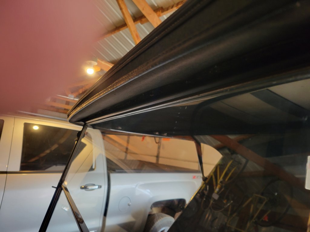

Post by got10carz » Mon Apr 04, 2022 12:52 pm
Jerry,this is my 23, done at Classtique in about 1974. I feel it works well. I've driven in downpours.
