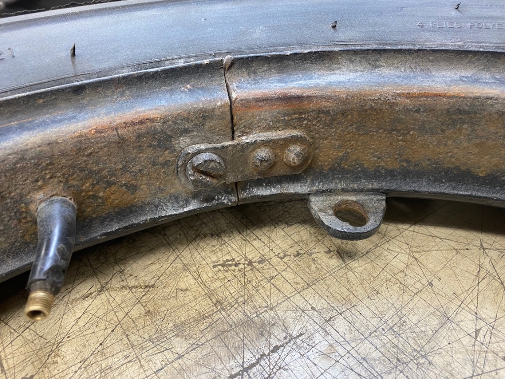

Anyway, four of my rims have the common hinge-pin joiners (lower photo) and the fifth has a screw-thru-tongue latch system (upper photo). This fifth rim looks otherwise identical to the other four, but will not slide fully onto the felloe and the valve stem hole, which is in the correct spot, is slightly smaller diameter. The rim lugs sit about 1/4" proud of the fellow, which makes the rim bolts the same amount short, and the nut threads are only partially engaged.
This rim is OK for my spare tire—particularly if my no-flat luck holds—but I'm curious: is this not actually a T rim despite all the similarities, or is it perhaps a T rim made to fit a slightly different T felloe?

21” rim looks good - depends if lugs match to felloe bolt holes. Valve stem looks to have Peyronie’s disease.

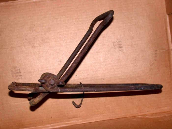

The lower photo shows a Canadian rim. There should be a pair of holes -n the outside flange on either side of the rim join. These were used when an exceedingly rare tool was used to collapse the rim when fitting tyres.
The top one is just like a Chev one I used, but had to shift the valve stem hole. Is there a slotted lug nearest the valve stem hole?

Allan, the first photo below shows those two holes, which are matched by an identical pair on the other side. I would dearly like to locate one of those rim tools. The reprint below is from a Ford of Canada August 1924 service bulletin and shows this tool and how it is used (plus another page of explanation, not shown). Very interesting to note that in summer 1924 Ford of Canada offered the split rims and balloon tires, which they describe as 4.40" x 29", as a $50 option. To my knowledge, these were not offered in the USA until the 1926 model year.
I am familiar with the almost-Model-T Chevy rims, and use a demountable clincher version for my '24 speedster spare. Its factory stem hole was in the wrong spot and had to be re-drilled. My odd rim has the stem hole as correct for Model Ts but no rogue hole elsewhere. It also has the slotted lug you asked about, but the slotting is not as pronounced as the other rims (2nd photo).

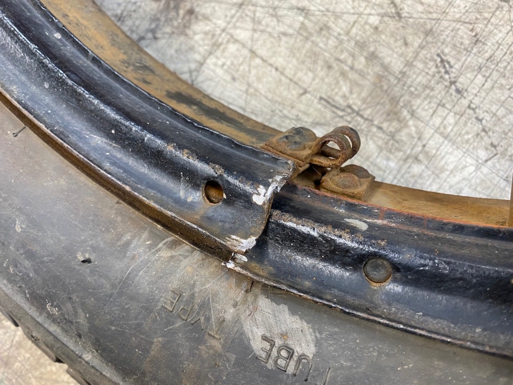

The Ford rim tool would be the way to go. I used a rim jack for this tire swap, and while it was manageable, the hinge-pin loops are easily damaged and tend to foul against the butt edge of the rim split. The one hinge-pin rim I illustrated in the OP had both loops on one side busted off long ago. When I mounted the previous tires in 2007, I tack-welded the two ends of the rim together to keep them aligned and gambled I wouldn't get many flats. That was a good bet, as there was nary a flat with any tire in 15 years.
The 1st photo shows the evidence of the hillbilly tack weld, the missing hinge loops, and how the rim split can easily foul those relatively fragile loops. I searched through a friend's junk pile and out of six rims there was only one usable loop fitting, which I salvaged and riveted onto my otherwise good rim. Looking at the Ford service bulletin, it appears that the Ford rim tool probably keeps the two rim butt edges from fouling as the rim is opened or closed.

That special tool is really rare. I have only ever seen/handled one,which I bought for a friend in Western Australia. It is made with what appears to be 5/16" spring steel wire. The components are wound together during manufacture, making for a tool of multiple parts which cannot be dis-assembled. It would have required some special tooling to make it in the first place.
In use, four ends engage in the four holes either side of the split. As the handles are brought together, not only do they collapse the rim, each half is cranked into the holes as the handles are brought together. Good luck trying to replicate it!!!

I have nothing to add to this discussion other than the following pictures of the Canadian Rim Tool, pictures which I culled from the interweb some years ago.
Canadian Split Rim 47214.jpg (36.84 KiB) Viewed 3075 times

The type with the slotted retaining bolt is what I and most 26-27 owners consider correct for those years. They replaced the earlier rotating latch type rim. I have seen pictures of the piano hing type, before, but never knew they were Canadian.
