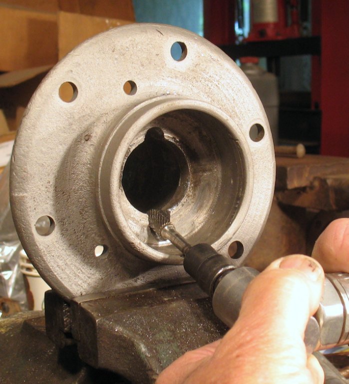

How hard is it to get the races out? Does it require a press? Just some careful hammering?
Posts: 7345
Re: Bearing Options
Post by Steve Jelf » Thu Apr 14, 2022 10:57 am
It depends on what hubs you're dealing with. If they're 1919-1927 they have notches that let you drive the cups out from the other side with a drift and a hammer. With 1918 and earlier hubs, weld a bead around the inside of the cup. It will shrink and fall out.
When I was working on new wheels for my 1915 I used 1917-1918 hubs, which are more substantial but were made to accept a speedometer gear. Knowing I would be using Timken bearings, I added notches.

Not hard at all. Just a punch from the opposite side of the race. Hit it equally on both sides and it should come out pretty easy. The other thing to watch for is loose races, especially the inners. Mine spun and so we had to punch the inside and use loctite.

Post by CatGuy » Thu Apr 14, 2022 11:03 am
Mine is a '26 so I should be fine.
