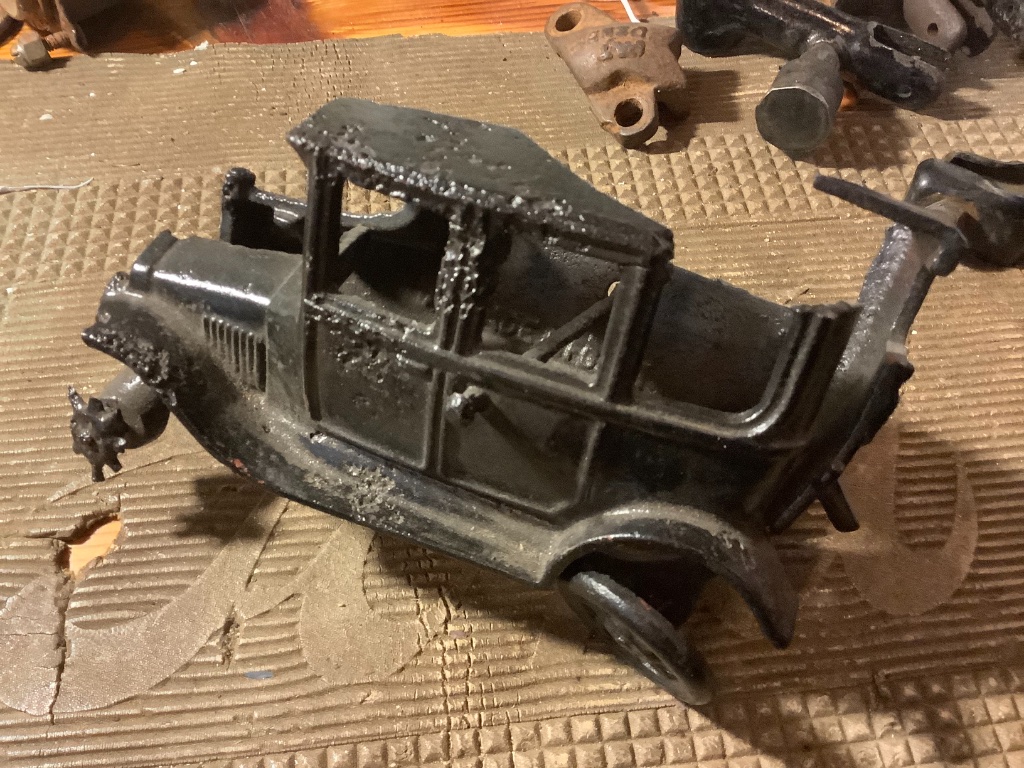

Re: How many times can you reuse lock washers.
Post by TXGOAT2 » Thu Apr 14, 2022 9:34 pm
I have some very old items made of babbit such as was commonly used in bearings a hundred years ago and more. Some of these are large shaft bearings and some are smaller, factory-cast and finished bearings. Some are simply blobs of babbit metal left over from bearing pours. Some are brass-backed with babbit overlay. They have laid around for decades out in the weather and show no deterioration. I have seen a number of old radio parts, phonograph parts, and some magneto parts made of a babbit-like metal that have become cracked and distorted or even fallen to pieces sitting on a shelf. I'm guessing these decayed items had too much zinc, or some other component, that oxidized.

Posts: 8633
Post by TXGOAT2 » Thu Apr 14, 2022 10:38 pm
Pot Metal, Base Metal.... similar to, but not the same as babbit metal.
Posts: 8633
Post by TXGOAT2 » Thu Apr 14, 2022 10:44 pm
Babbitt Metal - McMaster-Carr
[Search domain mcmaster.com] https://www.mcmaster.com › babbitt-metal
Casting Metals Melt and pour these alloys into molds to create metal parts and prototypes. Lead-base babbitt is a soft alloy. Use it to cast light-load bearings. It has superior antifriction properties. Lead-base coppered babbitt is able to withstand shock and vibration and requires less lubrication than other types of babbitt......
