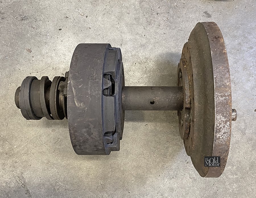

The flywheel that was lightened in the late teens for our 1913 racing car.
In the period, racers would turn down a Ford flywheel in a lathe to about 10" in diameter to prevent this. It also allows the engine to rev up quicker and improves acceleration. To run safely at engine speeds above 3500 to 4,000 RPM, the "speed merchants," Fronty, Green Engineering, Roof, and others sold small diameter racing flywheels machined from chrome-nickel steel.
