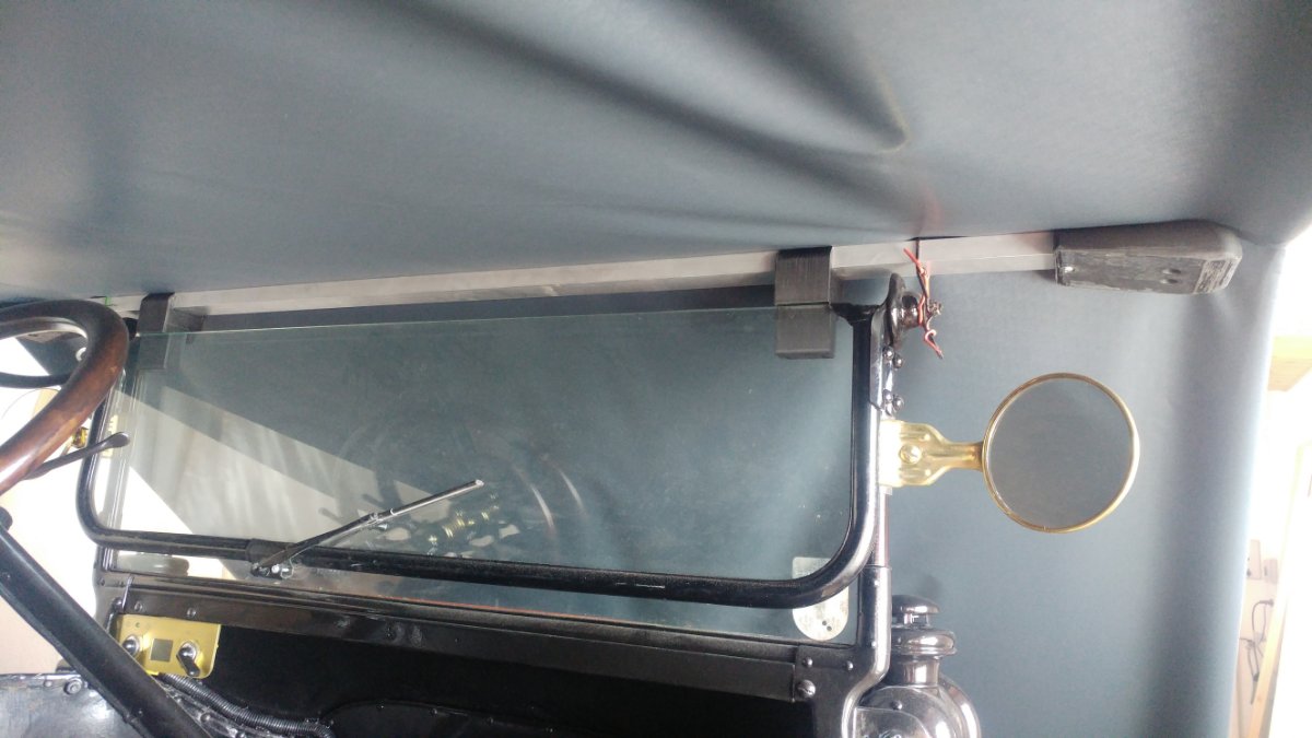

1. Cover Support
The first job was finding a solution for protecting the transport cover from being damaged by sharp edges of windshield.
I ended up with this simple and efficient solution, a 40x20x2mm aluminum profile, held in place by two parts out of my 3D printer and end parts with big radius on all corners (also from 3D printer). The carriers slide in between both windshield glasses and rests on them. Finally I will use two ribbons to secure the Cover Support in place (currently I used a piece of wire). This cover support simplifies things a lot, I also can leave the mirrors permanently mounted.
Self built support for the cover

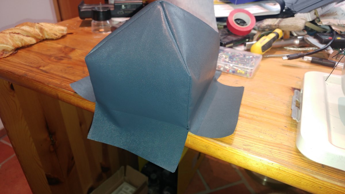

3. Some more details:
Last two pictures show the finished cover for radiator neck. It is 12x12cm and will replace the temporary cutout. It is big enough to not rub or pull on Radiator Neck. To protect all edges and brass, I will use an old comforter with a hole for radiator neck, covering entire front (both fenders + radiator).
Radiator Cap cover
Radiator Cap cover
Flap planned on back end
My next steps are attaching the side covers with fixing pins to the top cover and reducing excess material to 2". Then I carefully have to get the cover off and sew the first of two sewing lines. This will replace the pin needles and give necessary strength. Then I wrap it around (beautiful side facing now outside) and do a test fit.
To be continued in next post ...

The entire cover will get a number of Eye Rivets to hook in bungee ropes to apply tension all around.
What I will do now is adding another seam along upper edges. Finally it will be sewn like this:
How it is finally sewn
The reason for sewing this way is simple. It gives lots more strength to the edges, also making them almost waterproof. The weight of the cover will sit on inner two flaps, so it will not wear out so quickly, too. Also it can be tensioned better in length direction.
Here the latest pictures.
I need to say that the cover will be folded up twice and sewn along its lower end, then Eye Rivets will be applied. It will still reach below step boards. Below step boards I will hook in bungee ropes to keep it under tension.
The reason for this huge opening on rear is simply explained. While towing on open trailer, any air that gets somewhere below the cover can get out there. The cover sits on a carrier mounted to the folded down windshield and on the folded-down top. The carrier has the function of giving the car everywhere the same width of 160cm (~63") and to keep forces away from the glass, it also allows to leave side mirrors mounted. This gives two openings between rear fenders and folded top where air can get out.
Because the cover will be tensioned around fenders and step boards, almost no air can get in there. In the front I will put an old comforter over fenders and radiator to protect edges, then some more bungee ropes will wrap it around the front axle. So - in theory - most air should stay outside, and what gets in will be sucked out on the rear.
Cover - Front view
Cover - Front view
Cover - Rear view
Cover - Rear view
Detail on back side
Detail on back side

I use a thread of 100% Polyester in #20 thickness with a special leather needle. This needle is #130 (so relatively thick) with a flat cutting tip (sold for sewing leather). A round needle doesn't work, there's not sufficient room for the thread in the hole.
Yesterday I spent 5-6 hours with doing the second seam along left and right upper edge. I use a robust household sewing machine (PFAFF 213), with an attached strong stepper motor, driving the handwheel by a self 3D printed timing belt pulley. This motor can run the machine in extremely low speed with full torque, while the normal motor would overheat within minutes. I need this low speed because the tarpauline is too heavy for the advance mechanism of this machine (it slips at high speeds). See Picture at the end.
Anyway, as you can see on following picture, it is sewn now and looks very nice. This picture also shows the big flap in closed position, while earlier pictures shup it in transport position.
A picture from my garage security cam
Nest step (comes this weekend) will be sewing the bottom edge all way around. I will fold up the tarpauline 2.5" and make two seams. Between them Eye-Rivest will be set. (This comes next weekend.)
BUT:
I don't worry about watertight seams too much. If one or the other drop gets in, it is still lots better than having no cover at all. And the tarpauline is in distance to the car, so the drop will trickle down along the tarpauline. Using this second seam is primarily for getting a nice appearance and high strength, tightness is on second place. Compare this picture with my previous ones and you will see the difference. :)
