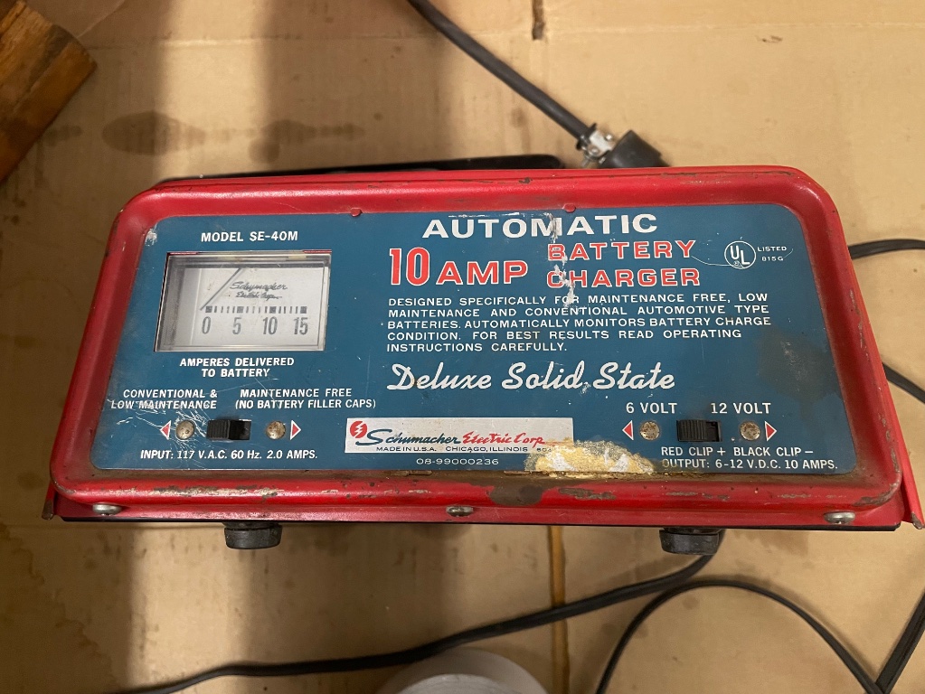

I thought the name Schumacher sounded familiar so went out and checked. I’ve had this charger well over 40 years, so long I can’t remember where I bought it. It’s the most useful and reliable piece of equipment I’ve ever owned. I’ve used it on all my car and airplane batteries (conventional and maintenance free) for as long I’ve owned it. Right now it’s maintaining the battery in my ‘25 express wagon, which has kaput magneto and generator. After a couple of days of driving (only 10 miles or so) it hits the battery (that came with the T last summer) with about 7 amps and settles down to near zero in a few hours. It’s been on several days now and the needle is just vibrating around zero.

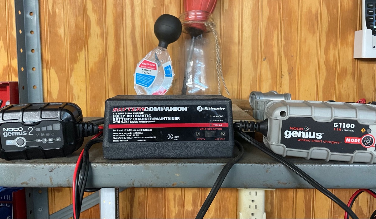

Same here, the NOCO little one on the left is supposed to work on 6v, but never has.
I mostly use the center one, works great!
The unit on the right is sold for the Optima Red Tops, and I like it too, works good. All are 6v-12v switchable.
BTY, I don't leave them on the battery for extended times, un-attended. Place them on the batteries every few weeks for just a day, then shut them down overnight, when leaving the garage.
Just in case!
