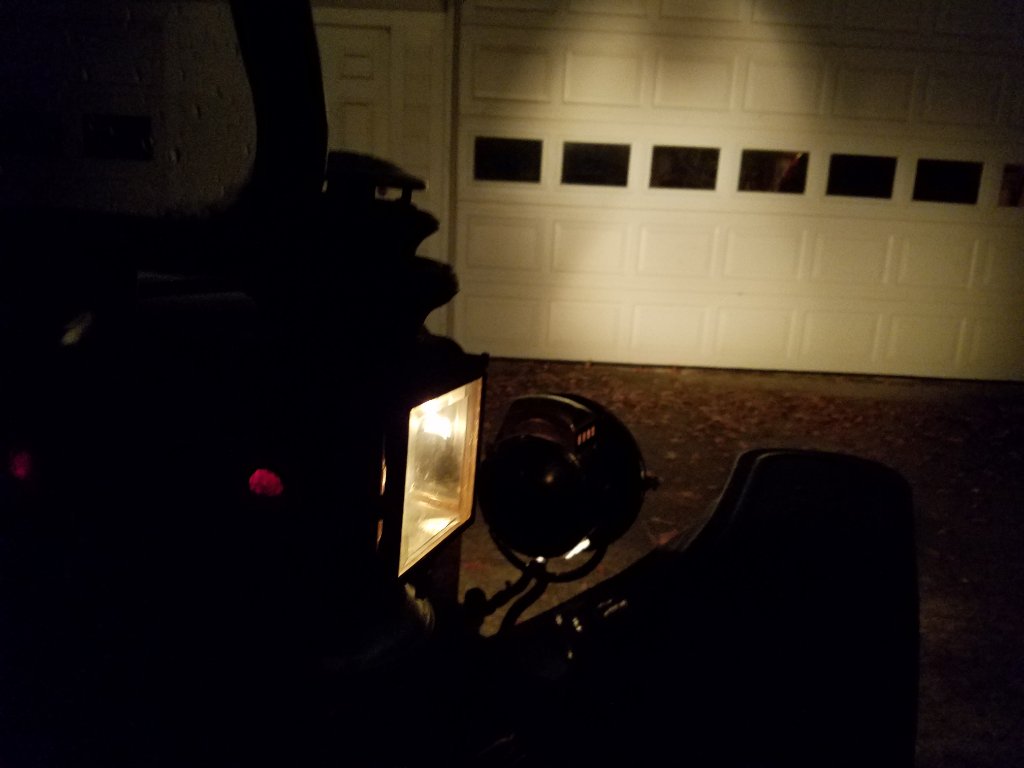

My friend installed the available reflector & Halogen bulb kit from Restoration Supply in his '13 - they are super bright but do draw major amperage - I installed the same kit in our '14 - they're crazy bright !
