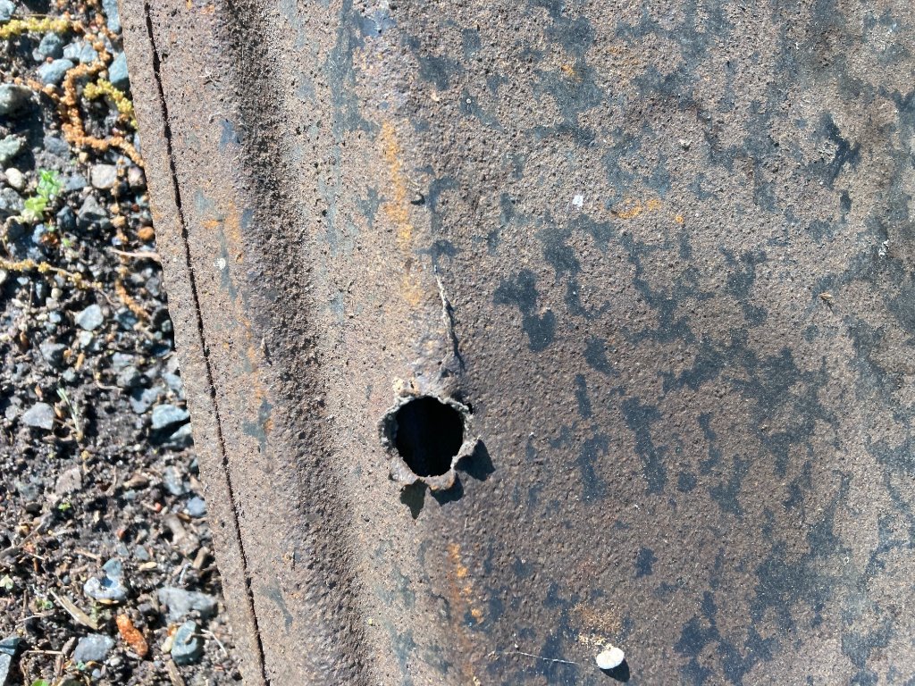

Tim, I am not wanting a nice clean hole. I want to duplicate the punched hole with the rounded triangles on the bottom side as in this picture. Art

I do want it to look correct and the rounded edges on the hole was to protect the rubber hose. Art

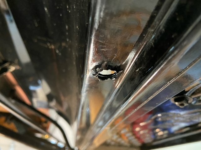

that is the type of hole I'd be inclined to make...just a simple rolled edge...not one crimped back on itself.

This is what I ended up with. I will roll the points up a little. Art
