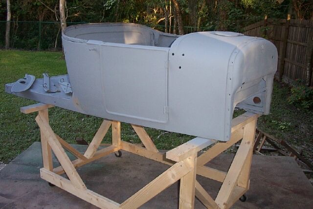

Go with your painter's recommendations. Safe easy way for him to paint all the body areas. Yes, he will use the body mounting brackets to secure the body to the rotating frame.
When you get the painted body back, put it right away on the chassis frame.
Wouldn't use the current rigged up jack stands and loose 2x4's for support, way too risky IMO.
Made a wood body dolly on wheels when doing my work / painting on bodies.

For me, easier to build a strong wood body dolly, on wheels. Fastened body to it at the body mount points, on all metal '26 runabout body, left doors on for painting, no issues with my buddy getting the gun to the undersides.
