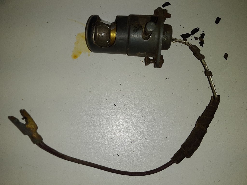

I would appreciate comments on these two items. Is the dash light reusable? Is there a way to check the ammeter? How does the back off the switch look? See any problems?

As for the dash light, IF you can get it apart, the wire should be soldered or crimped to the contact plate inside the socket. If soldered, unsolder the original and solder on a new wire. If crimped, cut off the original as close to the crimp as possible, and solder on a new wire. If the rest of the light is in good condition, it should work as new. Cleaning and removing any corrosion inside the socket is a must. The bulb will need to make good contact with the housing and the contact plate.

Look at the photo of the back of the dash light. Could I just tape the bare wire as close to the back as possible?

The wire on the dash light will have to be replaced.

I believe that wire will be a serious hazard and could ground out causing whatever you might put on it to melt and maybe catch fire. I agree with Pat, the wire needs to be replaced.
I have had one of these types of lights apart. That doesn't mean it will be the same as yours but this might give you some ideas. The bulb cover usually just pulls off since it may be a friction fit. The "on/off" lever on mine was threaded in. Be careful as it is spring-loaded. Once you have the on/off lever out, all of it should come out with the wire sliding through the hole in the bottom. Replace the wire, clean, and reassemble. You should be back in business.

As Terry posted , easy to take apart. If the spring is rusted use a hardware store replacement. If the insulator disc is bad, source new from any single contact lamp socket. Be sure to insulate that hot wire, the lamp housing is ground.
