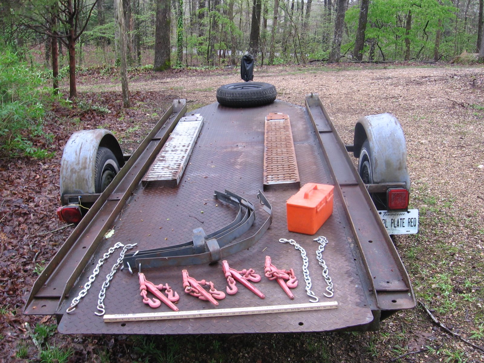

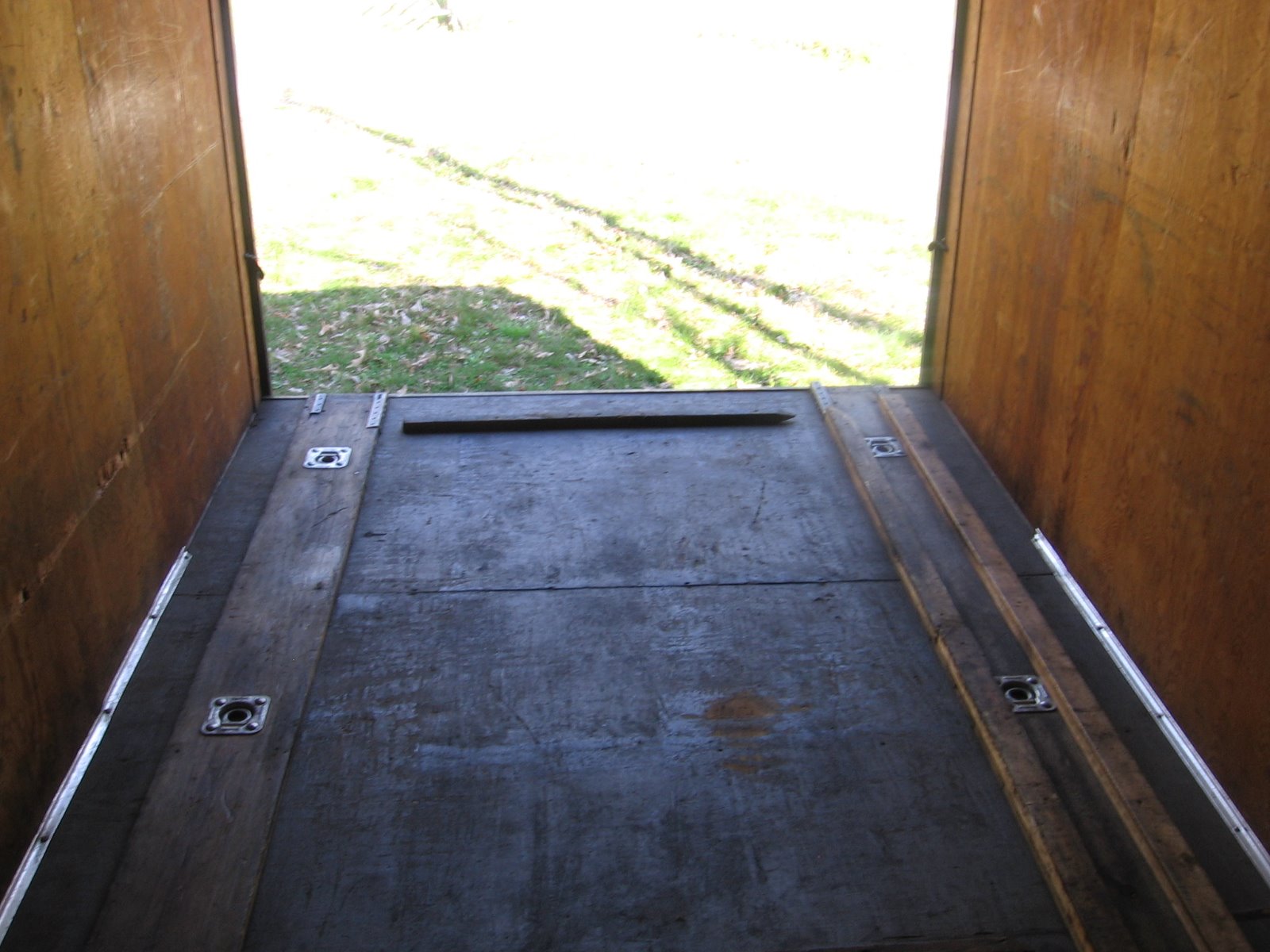

Tim,
Attached are several photos of my open and closed trailers that both use 2" wide, 3 ft. long metal straps with two angled wings (3rd photo) that go over each tire to hold my T down during transport. I do use the hand brake in addition to the tie downs. The enclosed trailer channel on the right in the 2nd photo and on the left in the last photo is 6" wide 2X3s so the T is always centered and will not move. The angle cut on the inside 2X3 is to aid the rear wheel to enter the channel. Let know if you have any questions that I may be able to help you with excluding next week's winning lottery numbers. :-)
Have a great day,
Dom
