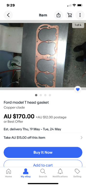

Post by Michael A » Mon May 16, 2022 8:02 am
eBay AU if any interest UD dollar maybe attractive to bulk order. Just a thought
