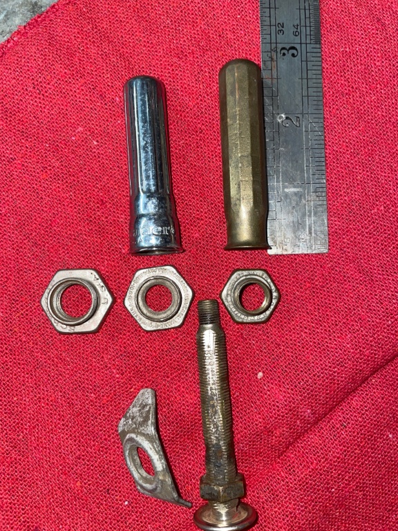

The original bridge washers are 'ribbed' underside to squish the area around the stem, that is better, but some are small dia, if you find the original other dia. that is bigger, it will fit over the new brass stems. Lots of old used parts and pieces of diff mfg stems and lock nuts, like Dill or others are out there to piece together what you want.
For me, you can find the original larger type lock nuts, they have a thinner hex, the repro hex of the new washers is too big, and these thinner are the larger type so original dust covers ( the ones in this photo are original larger size covers that I re-nickeled with Caswell kit, to bring back the shine) or the repro new dust covers can fit these original lock nuts. That way no one will suspect your have 'wrong' fat brass stems! They hide under the covers.
I suppose the modern bridge washer is adequate on a new metal stem tube with the stem vulcanized into the rubber. But if you're installing your own stems you want the original style washer.
