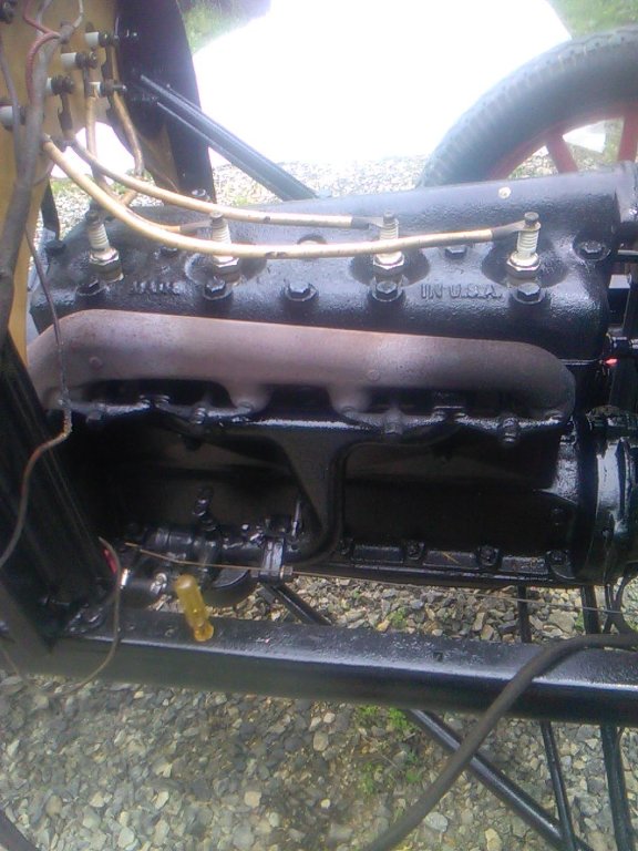

I painted the engine & exhaust with Rustoleum 500 degree engine paint waited about a week and started the 1916 T and it burnt the paint off the manifold exhaust and tail pipe. Is that normal or do I have a problem?

Probably normal, but! Be sure your initial timing is correct and that you are using the spark advance lever correctly. Late timing will cause the exhaust manifold to run much hottor than normal. An excessively lean fuel mixture can contribute to excessive exhaust manifold temperature as well.

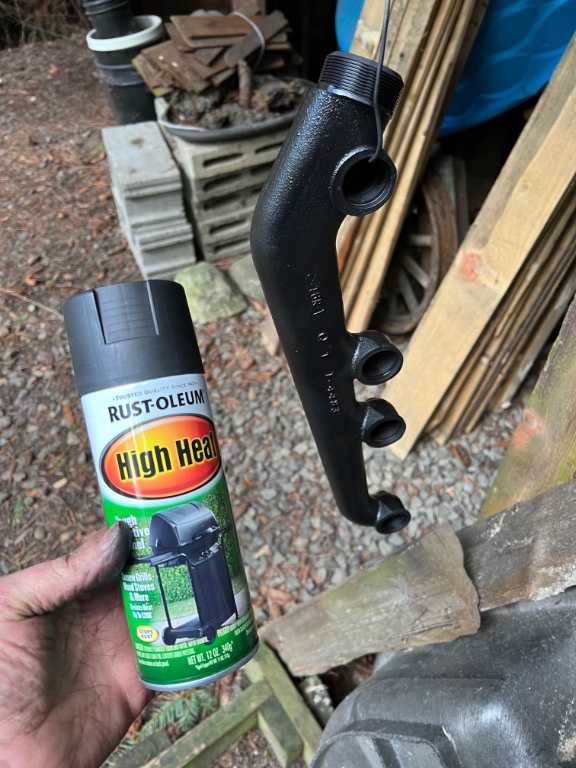

KBurket
Posts: 177
Joined: Mon Dec 14, 2020 1:17 pm
First Name: K
Last Name: Burket
* REQUIRED* Type and Year of Model Ts owned: 1926 RPU
Location: Seattle,Wa
Re: engine paint
Post by KBurket » Mon May 23, 2022 10:38 pm
I’ve used Rustoleum High Heat after cleaning the rust off with my wire wheel. It’s held up well.
