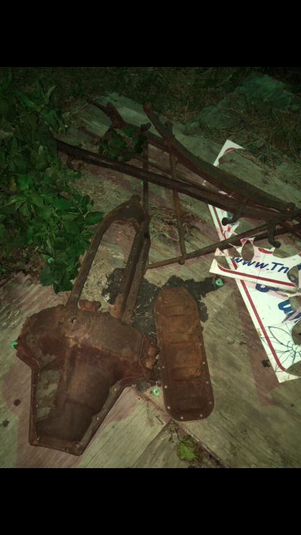

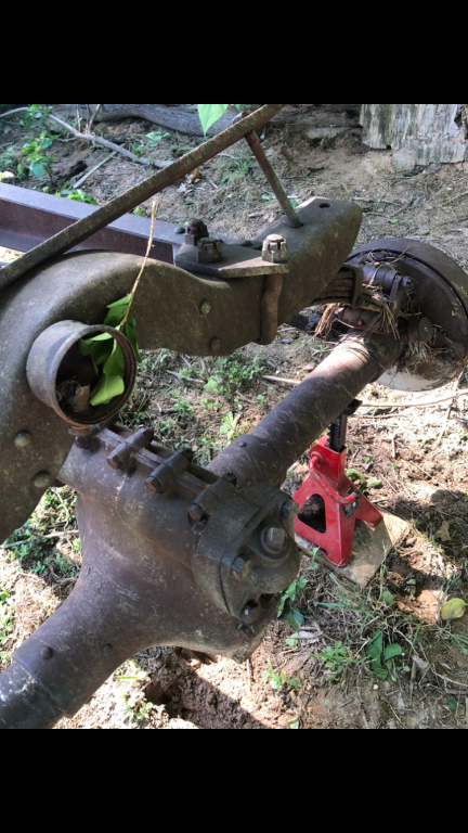

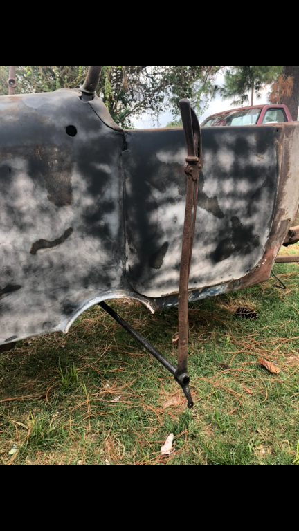

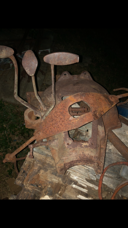

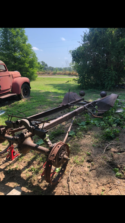

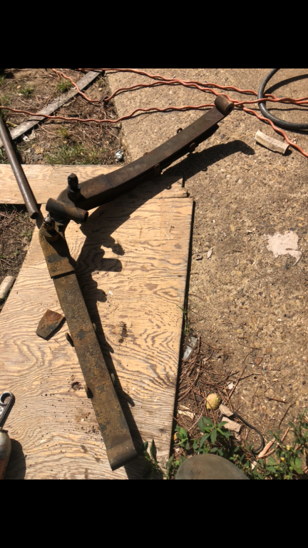

I’ve got a start to one. I don’t know anything about it really. It’s a late model, it came with 2 blocks and a 4 dip pan, lots of stuff, fellows, bands, steering column, even the straps from the back of the hogshead to the frame. I’ve got a late model transmission already. I just got it today but it’s about as much of a T as I ever get because I enjoy putting them together so here I go again. I’ll see tomorrow if the numbers on one of the blocks matches the frame. TT’s also had numbers on the frames also in 26-27 I suppose. I had to go to high school graduation after unloading it so I didn’t get to sort through it all.

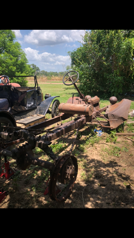

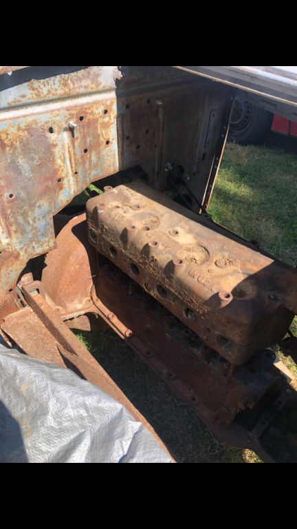

I had to go to graduation last night so I just got to sort through this stuff and get the chassis off the ground. It has body brackets up front, starter switch and electric taillight. I put one of the spare blocks in my Overland body speedster so I can figure out how to make it neater where the exhaust goes since I’m working on the motor that I’m putting into it.

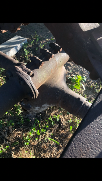

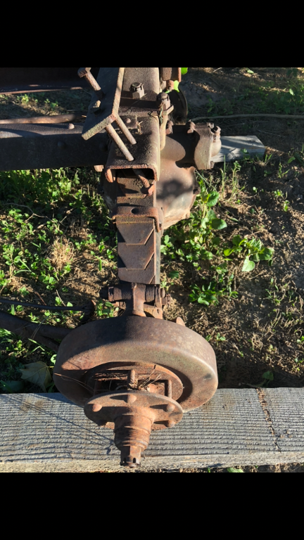

There are two worm/ring gear ratio possibilities for TT s. The cast iron worm gear with 4 ‘wraps’ is the slowest - 7.15:1 and the one with 6 ‘wraps’ is the “fastest” - 5.25:1. Unfortunately the latter ratio has been usually associated with TT Ruckstell rear ends. What kind of body do you have or will you use ? Looks like there’s some sandblasting in your future 😁🇺🇦

I think I have the 7.15:1 gears. 2 turns of one wheel = 7.15 turns of the driveshaft. I don’t really know about a body yet. It’ll be a slow process but I couldn’t pass it up being 7 miles down the road.

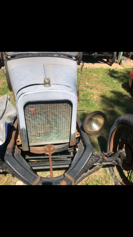

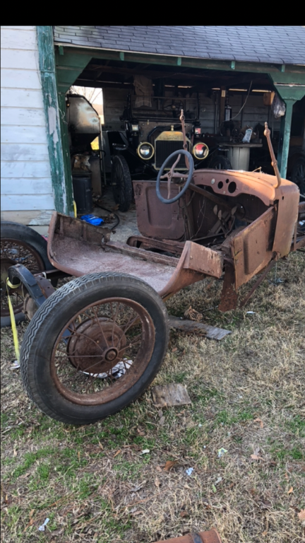

I am intrigued by your last photo of what appears to be an unusual front end? Can you show more of what it is we are seeing?

It’s a front end from a 1925 Overland Model 91. I bought the front half of what was left of a touring to get the windshield frame for an Overland I was working on. I had an extra T frame with a bent front axle so I thought I’ll use the cool front end and the body on a T frame. The axle is in the same place as a T axle would have been. I did lower it some and Z the frame in the rear. I adapted the Overland hubs to use the 28-29 Model A wheels that came with the T chassis. Most of the bottom body sheet metal is from 1970 something Chevy truck door skins. I had to buy another windshield frame since the one I bought the parts car for went with the other car.

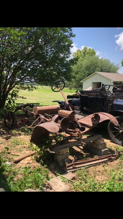

Adding the fenders helped but I’ll have to find some shackles and put the front end back, then I may cut out a firewall and put the steering column, an old rusted out gas tank and an old radiator then it will at least look like something sitting there until I get around to it. I might can save one of those fenders.

Thanks for the extra pictures Corey, it looks a neat idea.

I found a TT steering bracket, a rusted out gas tank, and I had a late model TT motor mount so I put a few more parts on to make it look more like a truck and not just junk piled up.
