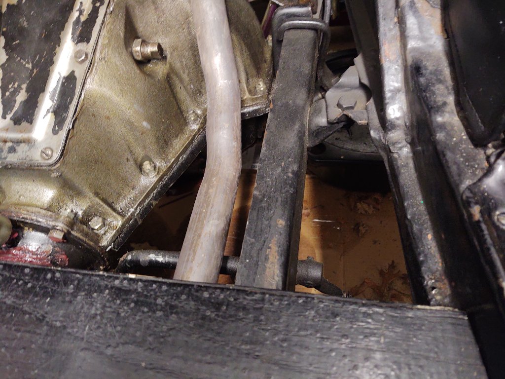

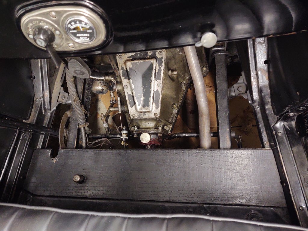

So we were putting in the rear floor and noticed some holes in the body of the car. I know the ones for the threshold but what are these for? They seem to be under the floor.

Those are new boards that you cut to replace the old ones?... The boards should cover everything that goes on the inside flange in front of the seat and on the sides. Previous owners on occasion did screw the wood floor board to the body

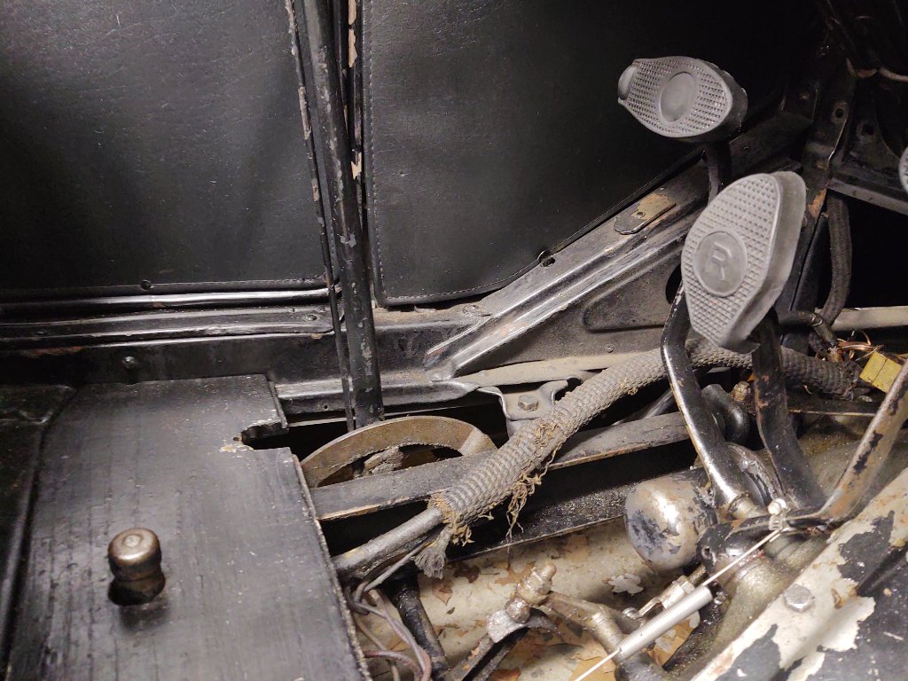

The floor boards are from JP Auto Wood. I bet that someone drilled out holes to hold down the floor. I know the ones where the door is are for the door sills. I'm going to have to beat some metal or trim some wood to make the drivers side fit.

Mopar man... I believe your wood floor strips were not cut wide enough. They do not rest on that inner flange all the way around. I had pictures of my front floor on a 26, the rear floor boards should be wide enough to fit inside the flange all the way around.

Those floorboards are not right. Front floorboards should be 3 pieces, upper, middle, bottom. Boards overlap so no gaps between them even with shrinkage. Front floorboards must fit well so they do not bind up the pedals.

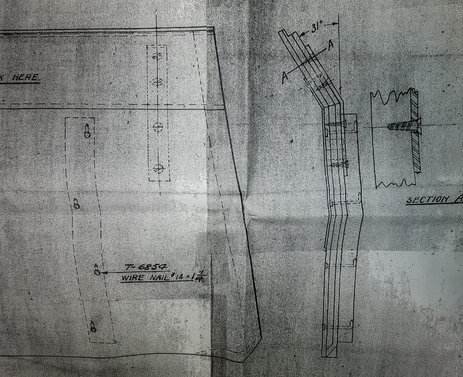

Robert,
I spent some time at the Benson Ford Research Center studying the 26-27 floorboard drawings. Here is part of the Ford factory drawing for the lower floorboard assembly called "Front Floor Board #3". It is a one piece fully assembled and painted part before it is installed on the assembly line in the car. Drawing shows the end grain wood splines, steel angle brackets, wood stringers, etc. The factory drawings made in 1925-26, the floorboards were made of random width boards jointed and glued together, in 1927, plywood was added as an acceptable wood. I suspect from your pictures your floorboards are not original Ford. You should see evidence of the 2 wood braces that were nailed to the bottom, evidence of the 3 metal brackets or screw holes, as well as wood splines in the end grain. The middle floorboard called floor board #2 should have a 1" finger hole for removing and installing the floorboards as well as the end grain splines. Floorboard #1 also has end splines but no finger hole. Hope this is helpful to you.

"Jeff... Since you know so much about your findings from the Ford research center, why don't you rear floorboards fit properly? ....."
Robert, I think you have me confused with the other Robert (Mopar-Man), the original poster. However, this is not the first time real hands on research thru Ford factory drawings has been met with hostility and doubt. Use or ignore my findings as you see fit. Hope someone will find it helpful or at least interesting as I do.
