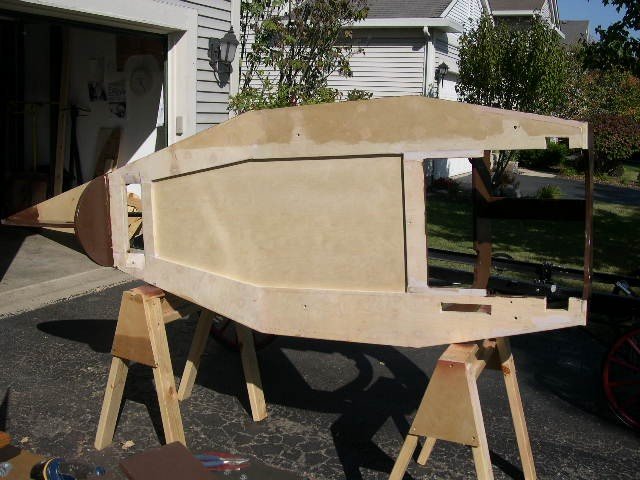

Hope the knee healing goes' well. I made my speedster body using 3/4" 10 ply plywood for the base. The local steel supply has 20 gauge angle in 1", 1 1/2" & 2" that can be easily formed to the plywood and spot or tack welded to the body giving a large area of support. I mounted mine to flat to the frame with rubber shock mounts under for cushion but rubber could be put between the mount and body keep in mind the frame is going to flex a lot.
Would love to see pics of the body when you are healed up but not before OK.
