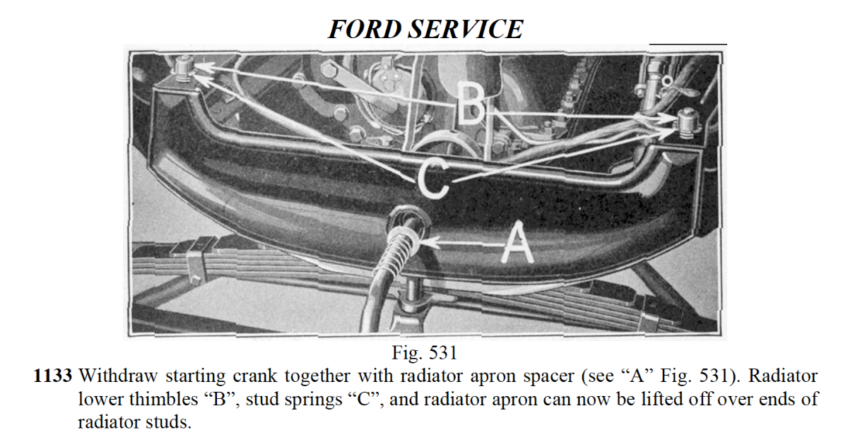

The apron that was on my 27 is like your gray one, no sign of a thimble ever having been there. I don't understand what the thimble is really for. Maybe on the earlier models without the mounting screw below the crank hole it avoided rattling by pushing the crank spring inward against the front engine support?
The repair manual shows a "spacer" for the improved cars. I would assume that contact with this smooth washer would allow the crank spring to turn more smoothly than against the cast iron front engine support.

The crank return spring sits in the thimble bottom.Eric Sole wrote: ↑Sat Jun 04, 2022 7:05 pmThe apron that was on my 27 is like your gray one, no sign of a thimble ever having been there. I don't understand what the thimble is really for. Maybe on the earlier models without the mounting screw below the crank hole it avoided rattling by pushing the crank spring inward against the front engine support?
