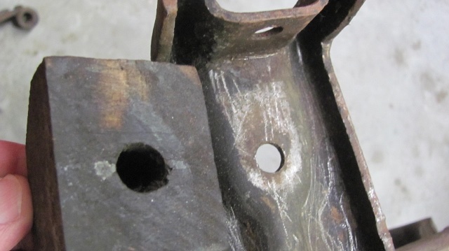

Ford used that method of engine mount, as the design is a 3-point suspension, for the lightweight twisting frame ability to meet the requirements of the T.
Leaving out this important block is IMO detrimental to the design. Note this original block removed, you can see the imprint of the crankcase arm, showing that it is giving support as the engine that moves during braking and forward motions, so a semi rigid support is needed. Wood does that job, these blocks are hard maple.
Without the wood blocks, there would be a large gap between the crankcase pan arms and the frame channel void, putting way to much stress on the pan arms.
The reason to not super fasten tight that long bolt is the wood block is doing its work, sandwiched firm between the frame channel and the crankcase arm, the bolt just keeps the shifting to a minimum.

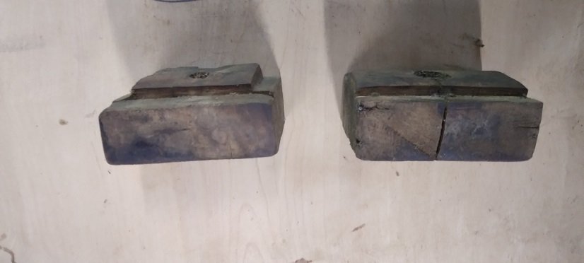

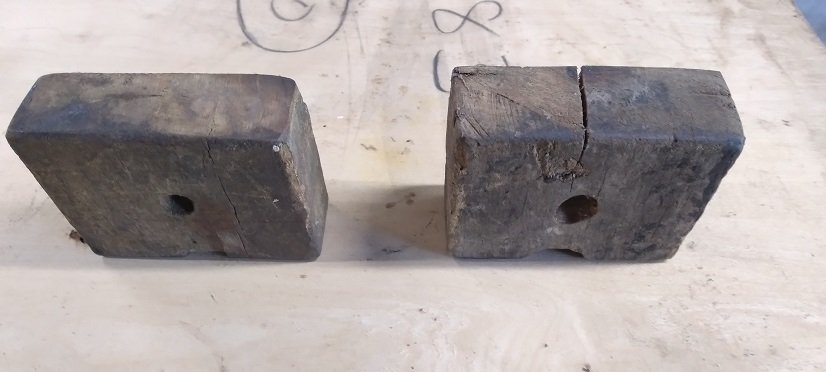

I think I have found original wood blocks in my stash of parts. I will try to find them and post pictures.

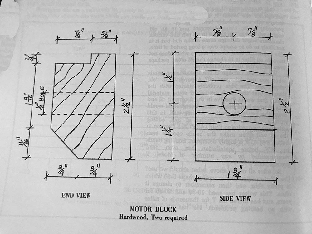

Maybe this will help

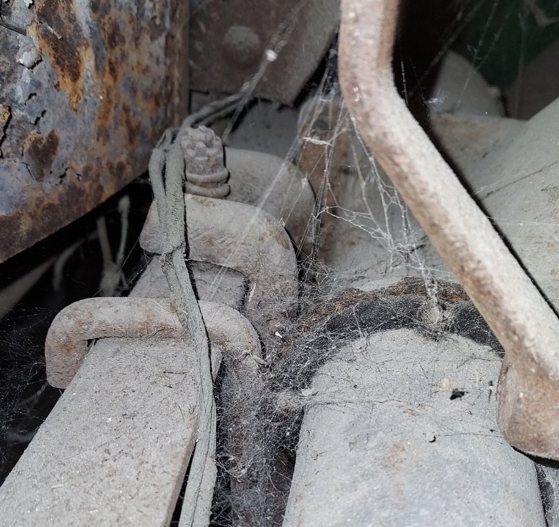

The notch at the base of the block on the passenger side is where the fuel line for the under seat gas tank is routed to prevent the fuel line from bouncing around the inside of the chassis channel. Jim Patrick

John iaccino

I think these are original wood blocks for the tranny mounts. What do you guys think?

I believe that Ford would not have hesitated to delete the blocks, bolts, and the costs and labor of making, stocking, and installing them if they were found not to be important. They are meant to limit side-to-side movement of the engine assembly in the flywheel area. They are not mean to be a solid, inflexible joint, and they aren't. The oil pan assembly is a stressed member in the Model T design. It has to absorb engine torque forces, engine vibration, thermal stresses, stresses arising from frame flexing, road pounding delivered directly to it via the front wishbone, and considerable forces delivered from the rear axle that result from drive forces, road pounding, and braking stresses. All this on top of supporting and locating the engine and transmission. The wood blocks divert much of these various loads directly to several squuare inches of the frame side members, rather than concentrating all of them in the pan ears at and near the point where the upper mount bolts attach to the frame flanges.
Posts: 8643
Re: Is there need for block of wood at trans mounts?
Post by TXGOAT2 » Mon Jun 06, 2022 11:15 am
Never seen any like those.

Thanks Dan for Herman’s info and thank you Tim Juhl for the dimensional diagram of these hard wood blocks. I shall now endeavor to build 7 pairs for my Model T s. I am now persuaded they’re necessary...
