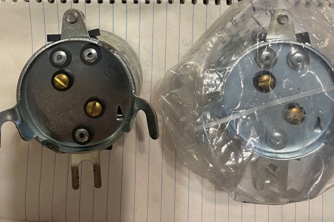

My '26 will not charge
I've tried jumping the cutout while running on BAT... nuthin'!
On both BAT/MAG, no charge when I put low beam on. High beam makes ammeter show 10 charging.
Below is a pic of my switch as it is wired. Is the ammeter wired backwards?
How do I get it to charge?

You have a wiring problem, not necessarily a generator problem.
1) a cut out will only connect or disconnect the generator to the battery circuit, it will not regulate the charging. The cutout is an electromagnet that will close the circuit with the battery when the generator is producing power to allow charging, or open the circuit if the generator is not producing power so the battery does not power the generator like a motor. The amount of output from the generator is set by the 3rd brush in the generator. As per the Ford Service Manual you can adjust the generator output to match your driving habits, higher charge rate for short drives or lower charge rates for longer drives, but once set that is what the generator puts out, regardless of how much power is actually needed to run lights and charge the battery.
2) turning on the headlights will not make the generator charge the battery more, it will either charge or not depending on the cutout being open or closed. Turing on lights and seeing a charge on the ammeter indicates the ammeter is wired backwards.
Turing on the lights should cause a discharge reading on the ammeter around 8-10 A with the engine not running, and a discharge of 0-4 A with the engine running and the generator producing power and the cutout closed.
Simple test: with the engine not running, turn on the lights, does the ammeter show a charge or a discharge? It should not show a charge as lights do not produce power, they consume power. That will show you if your meter is wired backwards.
The Mag circuit will ONLY power the coils if so selected at the ignition switch. The Mag circuit is independent of the battery, generator, lights, ammeter, horn, etc. The Mag system and the battery system will never mix, comingle, or swap power. The only way to use Mag power in a starter/generator equipped Model T is power into the coils and out thru the spark plugs if Mag is selected at the ignition switch.

Is there any chance the meter is bad? It came with the car, history unknown. If wired backwards, it's still wired per the diagram. So are the internals of the ammeter bad?
On my '23 I have to jump the cutout to get it to charge. When I do I always get sparks upon making contact on either side of the cutout. ---> This is not happening on my '26 (car in question). <---
What does this mean? The generator circuit is not grounded? Do I have paint blocking contact between the generator and the block possibly?

Some reproduction ammeters for the Ford Model A look similar to some reproduction Model T ammeters and the Model A is a positive ground system. If your ammeter is working backwards it is for the Model A and the two wires on the back need to be switched.

TEST RESULTS:
With battery on I put the low beam on and got a charge indicated of about 5.
With battery on I then put the high beam on and saw an indicated charge of 10.
**Car was not running during testing.
"Turing on lights and seeing a charge on the ammeter indicates the ammeter is wired backwards.
Simple test: with the engine not running, turn on the lights, does the ammeter show a charge or a discharge."

Good. Now reverse the connections to the ammeter and test again, should show a discharge.

First, reverse the ammeter connections and test. If the ammeter is now showing a discharge with lights on, the ammeter is probably good.
Then test the cutout as follows:
With the engine off and the battery hooked up, place a test light on the rear connection of the cutout, you should get a hot connection. Then put the test light on the front side of the cutout, it should not be hot.
Start the engine and see if ammeter is showing a charge with the lights off. Test the same cutout connections with the engine running and report back.

Ammeter wires reversed. Now reading discharge on low beam (5) and high beam(10).
Cut out tested with test light. Power side at radiator side is hot with battery turned on (I have a cut off switch).
Firewall side of cut out has no power.

We're all good now. I have a correctly functioning ammeter gauge and cut out.
This was determined thru the unbelievably kind support of a board member via phone minutes ago, and all the great info/guidance here.
Only thing left is to adjust the 3rd brush a bit.
