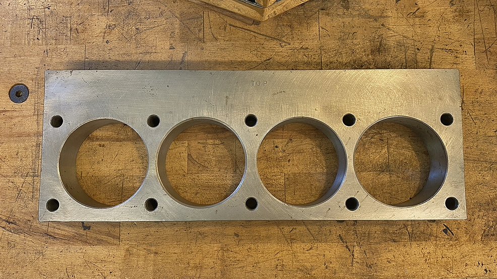

Brent gave an excellent explanation above of how cylinder blocks should be bored and honed. I'll add a little bit of info to what he shared about the use of a torque plate.
Whenever you bolt a head on a block and torque the fasteners the cylinder bore changes shape depending on the block, by as much as .003 to .004 thousandths. In addition to causing piston and cylinder wall scuffing it causes blow-by because the rings can't seal to the warped area of the cylinder which is generally in the area of each head bolt.
If the cylinders are bored and honed with a plate and a gasket to simulate the the torque load it turns out to be perfectly round; and it returns to the same shape again when the head and gasket are torqued again at final assembly. You may ask why worry about a few thousandths? Well, without the blow-by and extra friction you may pick up a couple of extra horsepower and more torque which means about a 10% increase in power, which when you only have 20 hp, 2HP is a significant increase without and engine changes. It will also extend engine like.
The 2" cast iron plate and spacers not shown in the photo was machined in house. Plates also usually have tubular spacers that go under each head bolt to simulate the thickness of the actual head. It would be a good club or region project to have some made up by a plate maker so that members could rent them when getting their block bored to help with the cost and to cover the shipping.
