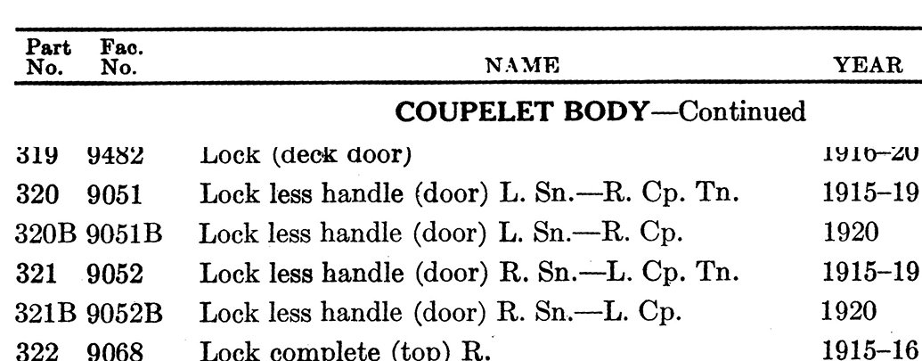

The way I read the part book numbers, the same lock (as they call it) is used on the Centerdoor as the Coupe. Since the Coupe opens backwards Left is Right and Right is Left.
Another book lists earlier "locks for the Coupelet. The numbers are the same with different letter suffixes.
