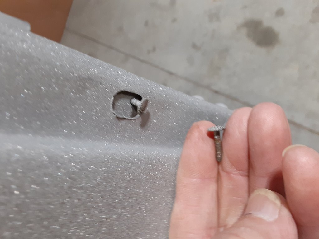

Re: Question: What Is The Best Way to ---?
Post by BLB27 » Wed Jun 15, 2022 12:04 am
Allan, A threaded nail was used on the two lower holes in my cowl, where there is no access to the back side. The nail is shown in the attached photos. I will try to reuse the nails, but if they don't work I will do what you did.
