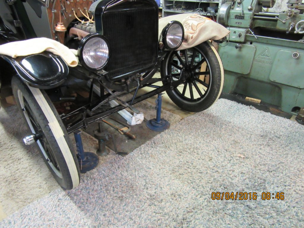

Joshua ; I do it always this way .
Toon

I scribe a mark on tape attached to the tire tread instead of Craig's method. I measure the distance between the marks with a 6 foot straight edge. I get the straight edge close to position with jack stands, then I clamp the zero end of the straight edge with a large clamp. Mark the straight edge where the scribed line is at the other wheel. Do this front and back and the difference is the toe-in.
In my opinion the toe in should be as close to zero as possible, but not zero. Keep in mind that the tie rod must be turn in complete one turns. One turn changes the toe in by about .21 inches.
