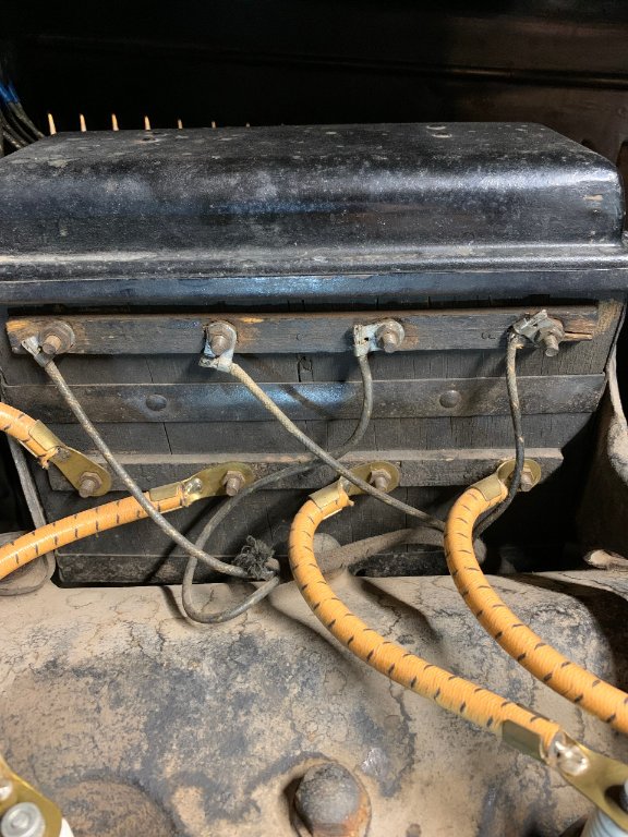

The condition of that coil box could explain a number of issues this car is having. Some TLC could probably improve its performance without spending money. If the inside of the box and the coils within it are in the same shape as the outside, it is in serious need of inspection and clean up. The engine cannot run any better than the ignition system performs, no matter how good the engine is.

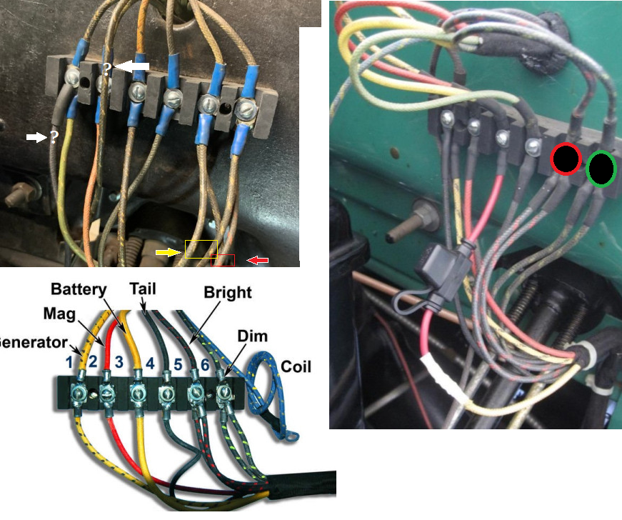

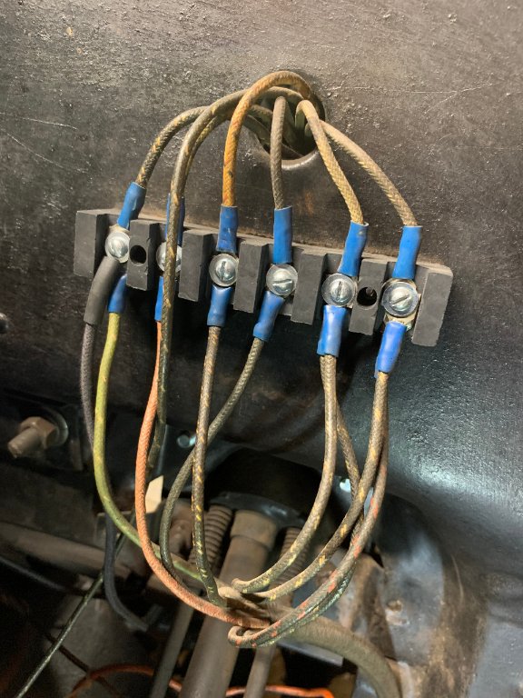

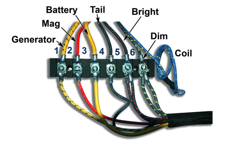

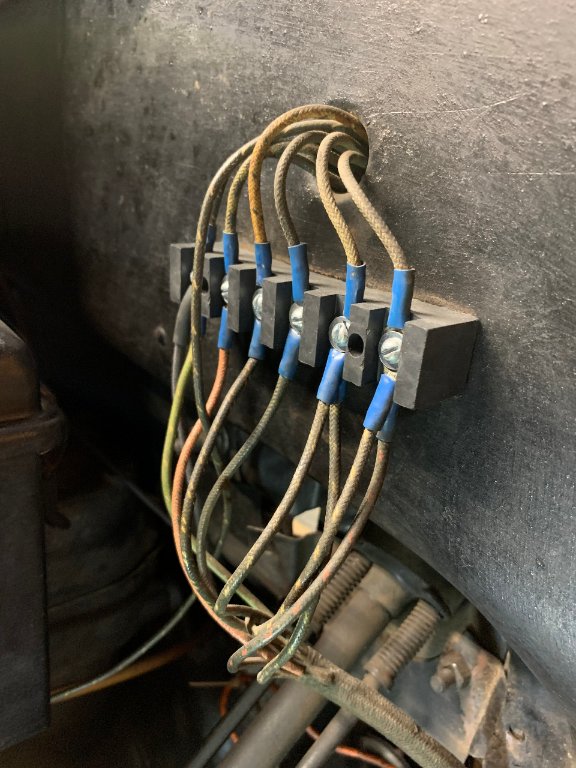

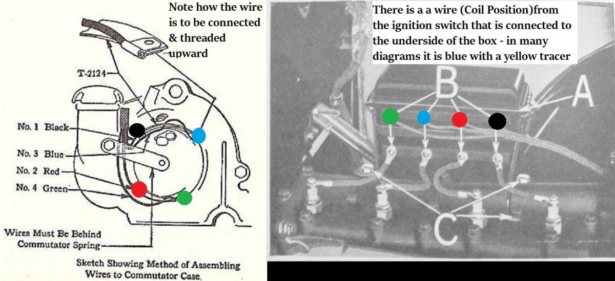

Wire colors are meant to help connect wire ends to their proper position. In looking at the terminal strip and wires coming through the firewall there are some issues to contend with.
The first is that your wire colors don't all match the bright colors in the wiring diagrams. As a result you need to disconnect one at a time and test the other end for continuity. Once done you need to tag or somehow mark both ends. Don't use numbers as they will confuse you with terminal positions) perhaps a letter and then record what its connected to at the other end (not the terminal block end).
In looking at the pictures posted there are some questions about the headlight wiring connections at the terminal block and if the correct wiring is correct. It just adds to the confusion
The coil box wiring looks incorrect based on wire length. Now someone may have corrected an error in wiring the commutator ends of those wires at the coil box but.... I would clean the ends of those wires and check the commutator connections and place wires were they are supposed to be an not adjust for an error

Location: Taxachusetts
Re: Mixed Up Wiring
Post by Professor Fate » Sun Jun 19, 2022 9:28 am
I think replacing the wiring, coil box wood for plastic, and the junction block is best. Rewire according to diagram and diagnostic test only if an issue pops up.
Ron's article is excellent and should be in everyone's library.
________________
**FATE**
Posts: 5248
First Name: john
Last Name: karvaly
Location: orange, ca
Re: Mixed Up Wiring
Post by speedytinc » Sun Jun 19, 2022 9:44 am
Thats an old repop harness. My concern: is, are the ends soldered or just crimped? Crimp only connections tend to fail over the long term. I have had some cheaper made harnesses & soldered all the connectors before installing.
