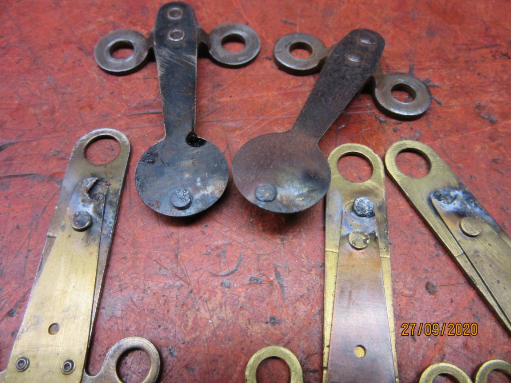

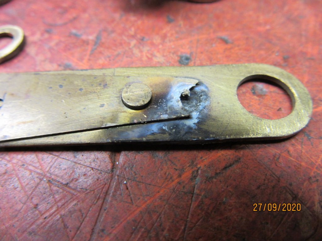

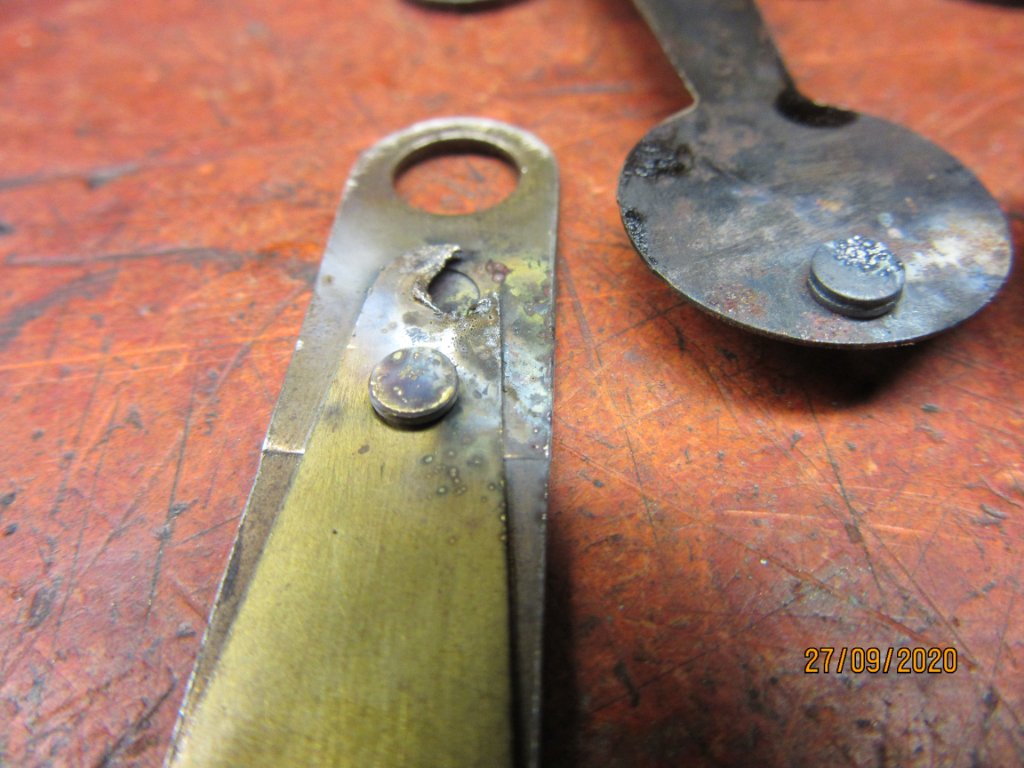

Re: "I have had 1 set of points that the top contact came off from the arm." /////// I had this happen with a set of KW points. The lower contact on one point set came off the steel spring. If your engine suddenly loses performance, this is one thing to visually check before you disturb anything else. In my case, the coil continued to fire, but the engine misfired at higher speeds. The situation rapidly got worse as the defective coil damaged the timer. Attempts to adjust the coils by ear worsened the problem. After damaging 2 good New Day timers and getting all 4 coils badly out of adjustment, I discovered the bad point set. I then repaired the bad point set with used parts sourced from a stationary engine and cleaned up the better timer as best I could, then tried to re-adjust the coils by ear. Failure. I adjusted the coils with the engine running and got better results, but still sub-par. A proper coil adjustment with an ECCT restored the engine to good performance at all speeds and ended the timer problems.

Post by ABoer » Wed Jun 22, 2022 9:13 am
Pat Mc.
Some years ago there was a batch of points who where
not good .
I had the same problem [see pictures ]
Toon

I had another issue with a set of used KW points failing after a few hundred miles. I believe that was due to my having filed away most all of the platinum from one of the point contacts, which allowed the steel beneath it to crater out.

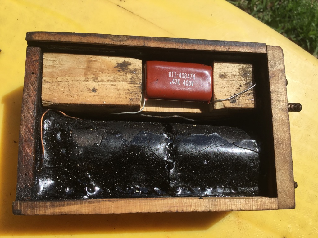

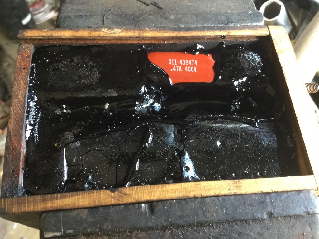

Steve they aren’t hard to repair. The caps sold
by the vendors are OK. Usually I remove the sliding door and gently pry off the short side next to the cap. Chipping out the tar and removing the cap is easy then. Solder in the new one and refill most of the space with wood bits. Save the tar I chip out and you’ll have enough to
Secure the loose parts. I melt my tar
In a Tin can outside with a propane torch. Done about 20 over the years.

Steve before U go out and get a 5 gal. Pail of tar check this out: as I said I’ve done about 20 over the years. I always work over a few pieces of newspaper or cardboard. The reason is I recollect the chipped out tar. I solder in the new cap and cut a small piece of wood to take up the space left open. I guess U could even cut the old cap and use that. A small tin can with a spout bent into one end and a vice grip for a handle is my tar melting ladle. A propane torch, outside of course, provides the heat. The point is to lock everything in place and total coverage isn’t strictly necessary. I’ve never needed to buy any tar. As stated I pry off the thin end of the box. The capacitor side. Makes working very much easier. I usually leave the glass insulator in place also. A few drops of wood glue on the fingers hold the side in place if loose. Truthfully the biggest deal about repairing coils is having a pal with an HCCT.

Steve, as Scott C. mentioned above, Type 3 steep roofing tar can be purchased from a local roofing company. I bought this 50lb bag for about $25 a number of years ago. I still have plenty left! Small bits don't chip off so easily in warm weather, but I'd be glad to send you a few lbs if you would like.

. Putting a block of wood in works to conserve weight and tar.

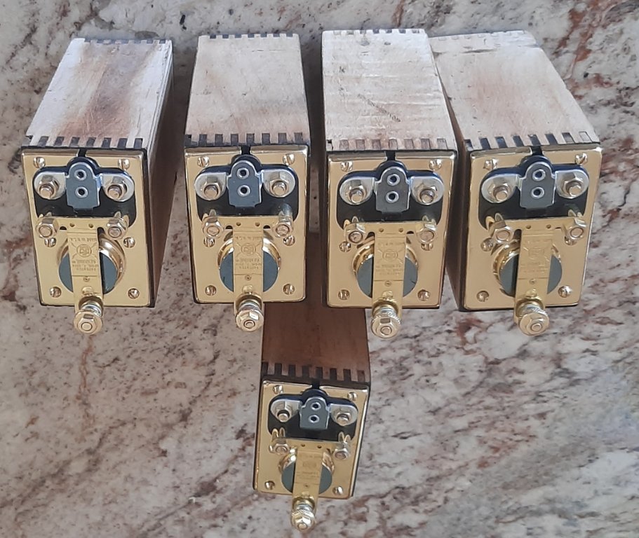

When I opened up the box and saw Brent's work, and then put them on the ECCT and found them all to be nominal, well, Brent is an Artisan of the highest order and I'm grateful for his skills.
The work on my wife's family "T" now continues.

That is a nice attribute of the ECCT, repeatability whithout having to read tea leaves and what it all means.
Beautiful work indeed.
