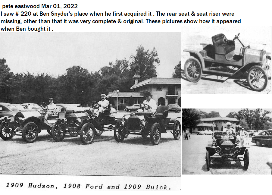

Here is the example of much controversy, mainly because there was little documentation, provenance, maintained over the life of the vehicle. Just hearsay evidence. So this "restored" vehicle has been claimed to be an "original" with engine #220. If you accept that the engine is "original" do you accept that the body is also "original" to the car or just and original body or does it matter . If it matters then explain how it meets that criteria.
