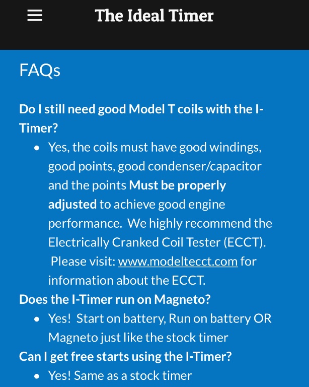

From Mike’s website
The I-Timer is 6-12v DC only.
