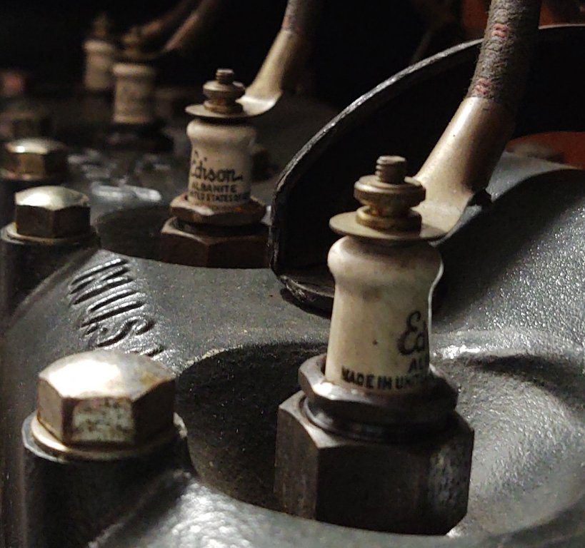

I agree that Champion X spark plugs are the best and most reliable, but it is historically interesting to see a T with Edison #14 spark plugs and Firestone parts that demonstrate how Ford and two of his best friends Thomas Edison and Harvey Firstone were not only friends in private, but were also affiliated with and supported eachother in business. Jim Patrick
Moxie26
Posts: 2068
Last Name: Jablonski
Location: New Jersey
Re: Which is better plug
Post by Moxie26 » Sun Jun 26, 2022 11:56 am
Edison # 14 spark plugs ..... in our '26, ... also installed in the '22 Touring at the Edison estate in West Orange, NJ.
