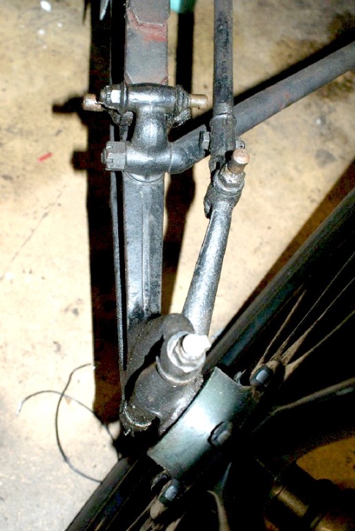

Here are some pictures I took with my old digital camera; the first is an overhead shot of the troublesome spindle hitting the axle and the other two are self-explanatory. Hopefully, this helps.

My wheel turned all the way, arm does not make contact with axel. Your arm may be bent, or you might have 1921 one piece spindles on there not 1910 spindles

I think I see your problem. You have the correct fine threaded drag link. I don’t know the correct lenght but your link may need adjustment. Adjust at both ends to leave about same amount of threads showing. This should place your steering pitman arm in the correct position if you have the correct pitman arm.
The 1921 one piece spindles were used with the later 1919-27 under axel wishbone. The 1921 steering arms would have the offset up to clear 1919-27 wishbone.
To get close first set for correct toe in with the drag link disconnected. Next place steering wheel so that the pitman arm is strength down. Adjust drag link to the measured distance between pitman arm and tie rod ball, having about equal adjustment treads showing at both ends of drag link. You should now have a centered steering and about the same turning radius both left and right, and have no binding or over center of steering.

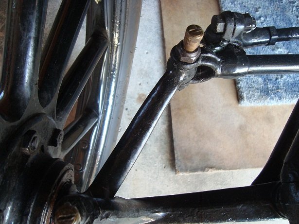

Here are a few more pictures of the spindles - they seem to be correct but I'm not certain. What does a "fat" spindle look like? sorry, I don't know why it keeps repeating the first pic!

Looking at these photos, I really don't think I have enough toe-in. I've also included a picture of the pitman arm, which I believe is correct. Again, any advice is always appreciated! I'll measure for toe-in tomorrow and let you know.

Iam not sure but is the spindle arm bent?

Wow, I never noticed that! Sure looks bent; I’ll do some investigating tomorrow when it’s light: good catch!

Your left spindle looks correct. The right one looks like a made over '21 spindle. To my eyes anyway...

I’m willing to say the passenger is bent or the wrong spindle. An original spindle and arm allows total movement and will not hit the axle when attached correctly. Look at how the arm comes off the spindle, it has a set back that allows total movement. The 21 do not.

Top has setback where arm comes out of spindle. The 21 shown on bottom has little to no set back, and the arm will hit axle before full turn is achieved.

You can bend the arm to a workable angle similar to the original spindle. Then you grind out the appropriate amount of indentation to allow a full turning of the wheel. You add some weld buildup to the backside of where you grind out the material for the indentation for added strength. I’ve seen some that had the whole arm removed and relocated to make a more appropriate angle that works. You just need a creative welder that can put some deep structural welds on the modifications to be sure they hold and are safe. Welds can be cleaned up and dressed with flap wheel on a handheld disc grinder. Then you can put your feelers out for a correct spindle and still enjoy the car.
Option 1 Relocate and reweld arm
Option 2 Bend to appropriate angle, grind indentation out, add weld on backside for support

Re: 1910 Steering issue question
The 4th picture down of Bill's posting is a fat one. The other of the replacement ones have a taper from the center out. I have an spare 1910 pr I am keeping. I will post a photo. My 1910 T has the correct early ones also.
I believe I’ve found an original one-piece RH spindle from a forum member, so I’ll post a finished project when it’s wrapped up. Thanks again for all the help fellas; much appreciated and much learned! BTW, are ‘21 one-piece spindles worth anything? Mine is in great shape with good threads and bearing surface!
Congrats Bill on finding the correct spindle. The last 1921 pair I know of sold for north of $350.
