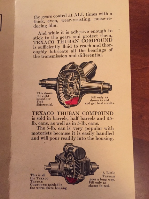

This is from a 1920’s Texaco gear oil brochure. It shows just enough oil to cover the bottom of the ring gear.

The old Texaco ad above says it all. Don't forget the pre 1918 filler plugs are higher than after 1918.
