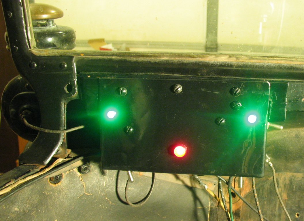

You don't need to drill any holes, at least in the sheet metal, for an accessory electronic device. One of my winter projects this year was installing tail/brake lights and turn/emergency signals in my 1915 runabout. The control panel has switches, indicator lights, and two outlets for phone, tire pump, GPS, etc. It clamps to the bottom of the dash. The only holes I made were in side lamp bolts, the trunk floor, and the top floor board. After reading horror stories of Ford ignition interfering with electronic accessories, I was relieved to find that everything works as intended.
